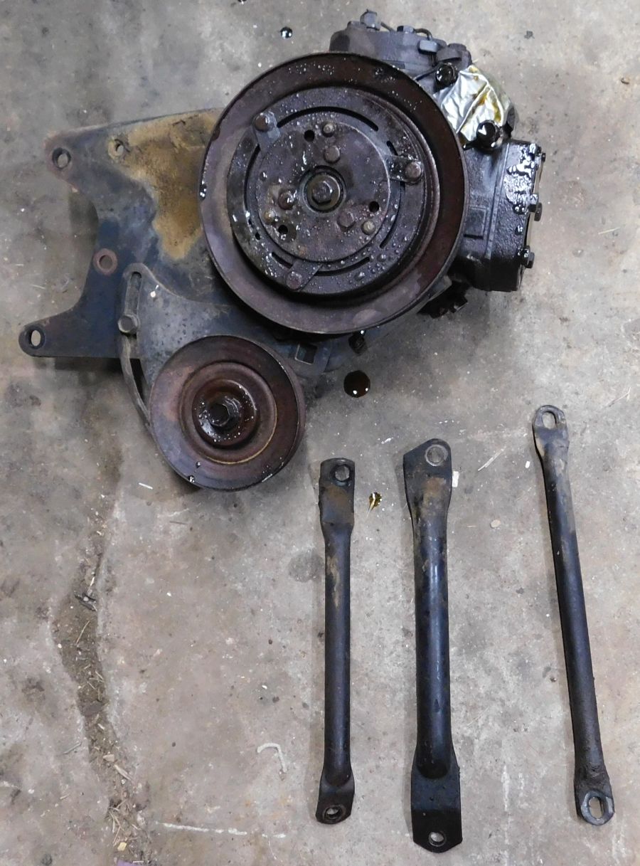

I do intend to cap it off with a cover plate, sealer and bolt just to keep the crud and insect nests out of it. :)
I can tell you this:

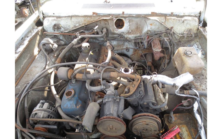

The engine still had all its original accessories on it including alternator, PS pump and AC compressor and brackets and there was not an air pump, bracket or pipe which would normally be mounted to the AC compressor mounted on the water pump bolts.
If there was an air pump on this engine then; somebody removed it a long time ago including the brackets and air pipe on head and left the port wide open with no carbon in the port from what was likely a smoking engine due to cracked and broken valve seals.
Thank you all for the assistance. I do believe this probably is a 1975 engine.

It might not necessarily ever have had an air pump. There was also the aspirator-type air injection setup, which had no pump involved—just a hose, with a check valve in, running from the clean side of the air cleaner to that port at the rear of the head.

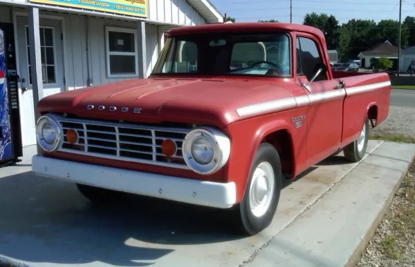

Well, sometimes things do cross dates in manufacturing such as they were still using the 1975 bracket when assembly line started producing the 1976 vehicles and there are also special orders for fleet deals and whatnot.
IE: The 1969 dodge pickup I used to own was actually an earlier body style from 1966-1967 with round headlight doors.
It was sold to the city of Denver as a part of a maintenance fleet.
Was totally a 66-67 D100 with slant 6 and manual steering and looked like this example only with city park Yellow over forest Green paint BUT was VIN and TITLED as a 1969 vehicle. 8)
