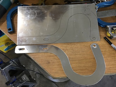

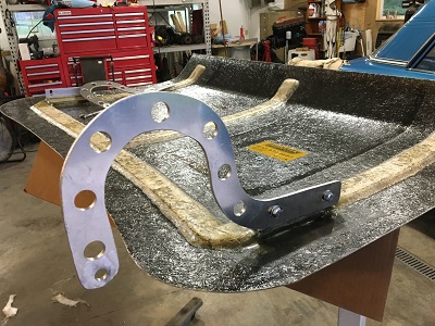

As soon as I got home I pulled off the steel trunk lid and brackets and began making my aluminum hinges for my fiberglass trunk lid. Here is one done, and one to go. I will glass on some brackets to my trunk just like I did the hood and have two hood pins to keep it in place. More to follow.
PS. Already spoke to Robbie (paint guy) and he is ready to paint it as soon as it is mounted on the car! :D :D
Deck hinges. If you want copies drop me a note.

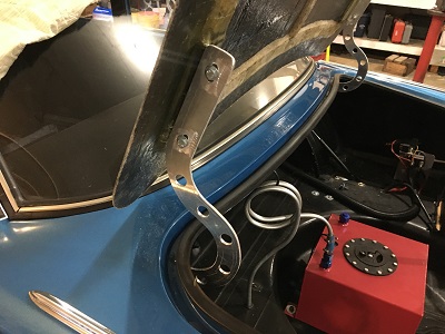

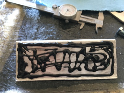

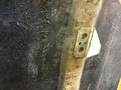

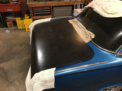

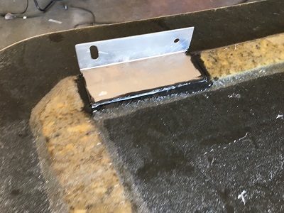

I got the hinges all done and the brackets Epoxied and glassed to the trunk lid. Only thing I need to do is make the "bumpers that it will rest against and the hood pins. You may not need the bumpers on a heavier trunk lid, but this is a race weight item and it has a little more flex at 10#. :D The hood surface looks like really nice quality too. I may need to sand a little more clearance on the side facing the rear glass. It is a little close to the sheet metal in that area.

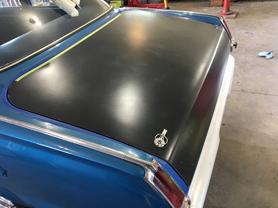

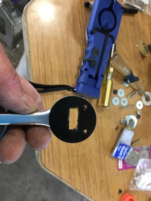

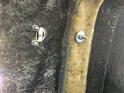

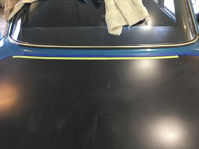

I got the trunk lid all done today. Trimmed about 1/8" off the back edge where the green tape is shown. Put a small tab in the center underside for the prop rod. Also put some round rubber washers between the hood pins and the deck lid to protect the paint when completed. Then I block sanded the whole thing and it was amazingly flat. :D :D Now it is up to the paint man when he want the car. :D :D
These bolt heads will get cut off once the hood pins are on for good. Rob will removed them to paint for sure.
