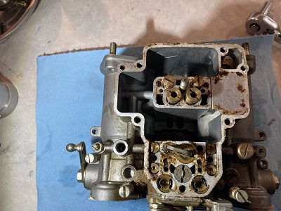

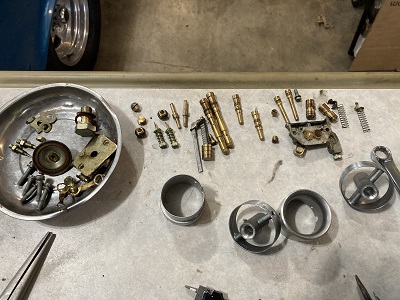

I got all my parts to swap in the 40MM venturis on my Webers. But I thought it best to take a peek inside the top covers and see what things looked like before I made the changes. I'm glad I did. There was a lot of "crude" in there in my opinion. So I went ahead and disassembled them and dropped them into our ultrasonic cooker for a good cleaning. Since everything, and I mean everything, is adjustable there are a lot of parts to these. I will let you know if it runs at all after I get all 3 cleaned. :D :D

Rick, is that ‘crud’ varnish left from the gasoline in the carb evaporating over time?
If so I wonder if there is someway to fully drain the gas from the carburetor between use?
My bet is that slant is going to run stronger after you get those carbs cleaned.
PostPosted: Tue Dec 28, 2021 4:41 am
Posts: 9335
John, I think you are correct.
