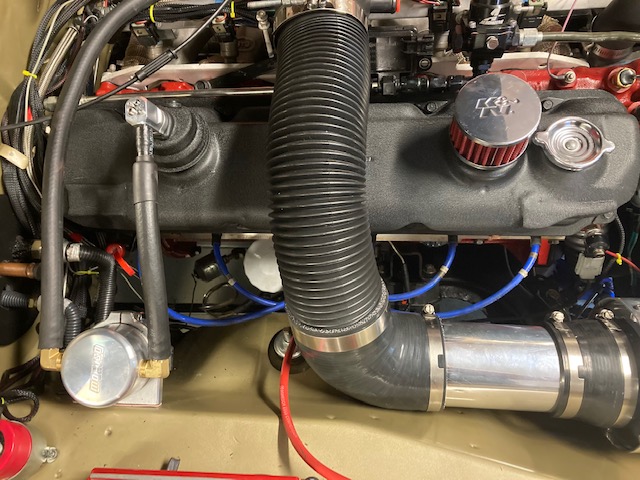

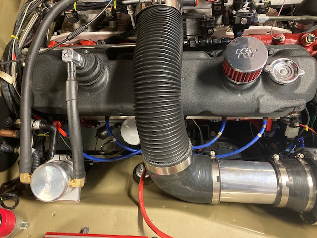

The B3 rocker shaft shims significantly reduced the travel of the rocker rollers across the valve stem tip.
But they also moved the rocker shaft up over .200 and to make that work I needed new pushrods and a modified valve cover.
I added up lifts on the ends of the valve cover for clearance and moved the vapor containing baffles to the outside of the valve cover. To make a nicer flow of the PCV piping I swapped
PCV and air intake positions.

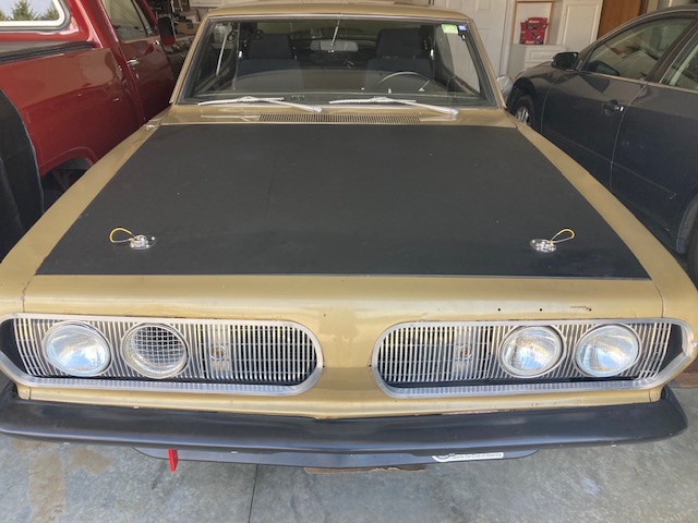

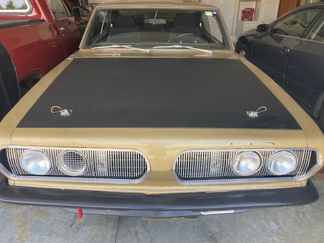

The goal of the new grill was to add an engine air intake, reminiscent of what was hot Rod stuff in the 60's and at the same time make it look like something Mopar could have done in 1968 and at the same time not do any changes that would impact re installing the original OE head lights and bezels.
This was an interesting project, and its done.

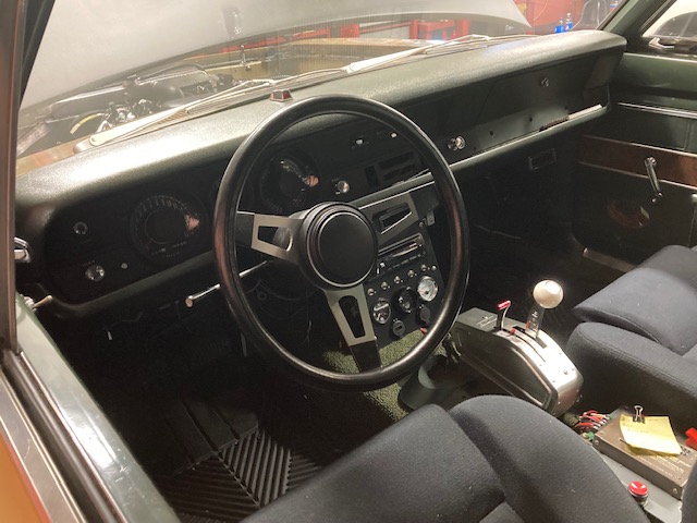

The OE steering wheel on this 68 Barracuda is just absolutely perfect. Has a nice shine, no cracks.
I am wanting to drive the car aggressively and I felt that a thicker steering wheel rim would give better
turning grip and at the same time I would not be stressing the nice OE steering wheel. I like the way the Tuff Wheel
looks and feels.

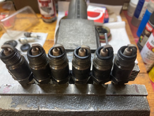

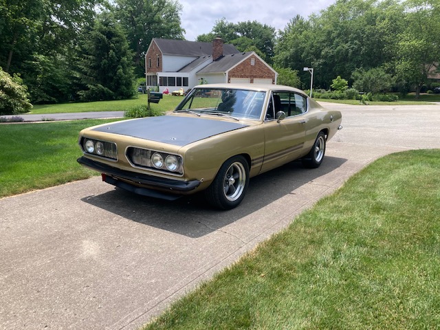

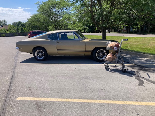

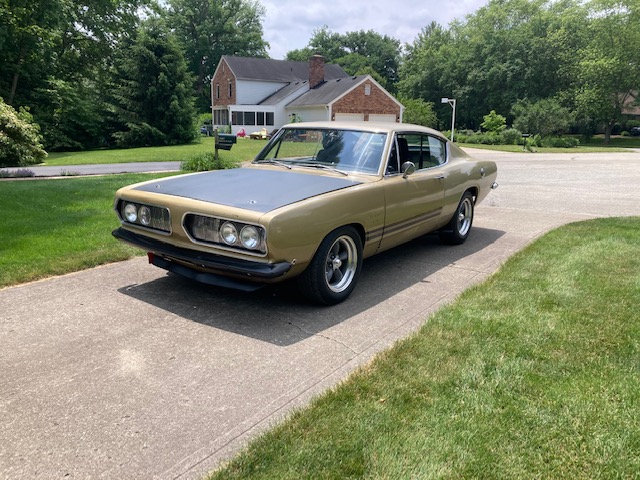

Been doing some local driving to run up a few break in miles and to establish the reliability of the car.
The photo below is of the car using it as a Grocery Getter. That day in the parking lot independently had two sets of folks approach me saying
"that car is just beautiful, what is it?"
I now have 330 miles on the car. The last trip was a 20 mile out and back, all highway. The fuel milage was 17.9 mpg on that stint.

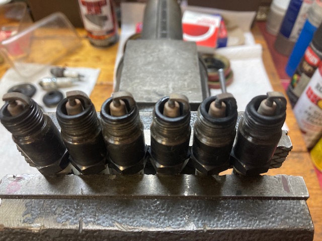

Pulled the sparkplugs to do a compression test
the cranking pressure for 1 to 6 are
195, 190, 183, 190, 183, 185
I also adjusted the valves
I have the AF and VE tables adjusted good enough that the car starts and drives easily. No bogs or hesitations.
I think I can tune it a bit better for more performance and economy.

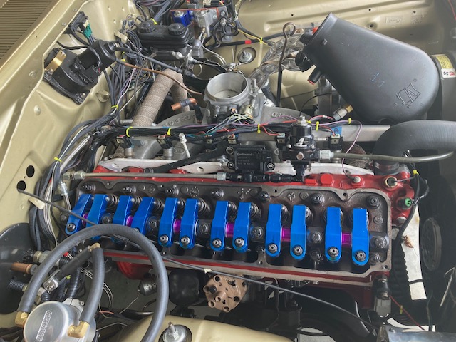

the next action item is to do more to restrict oil to the valve train. I wanted the roller rockers to get plenty of oil, and there is.
I have an oil separator on the PVC valve piping and the separator reservoir will fill in about 100 miles of driving.
PostPosted: Sat Nov 18, 2023 5:02 pm
Posts: 3864
An update on the restriction of oil to the top end project.
Some background: the head is an 87 hydraulic lifter head, the cam core is a hydraulic cam core with the full groove on the read bearing journal, the oil pump is a hydraulic motor aluminum body pump with the wide rotor.
I added a Moroso canister in the PVC piping as oil was getting into the plenum through the PVC piping. That helped but the accumulator would fill in about 100 miles of highway driving.

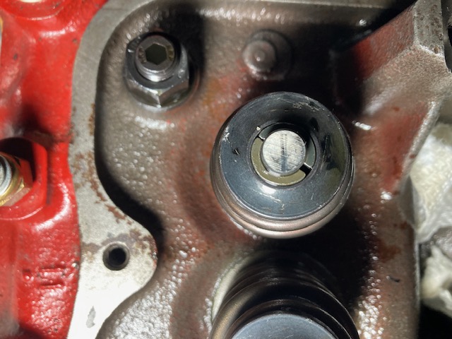

The roller rocker shaft is raised and moved a bit off center using B3 Rocker stands. The B3 Rocker stands did a fine job of centering and reducing the roller travel across the valve stem tip.
See Photo below.

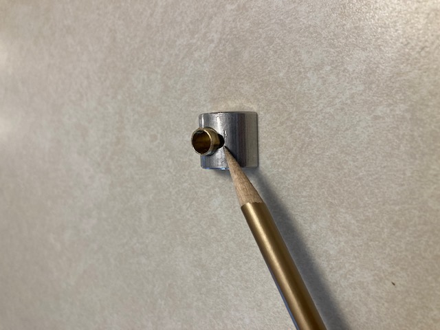

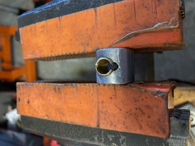

The stand at the #6 end has clearance cuts at the mounting bolt hole. I made a brass bushing to fit inside the stand bolt hole to take away the clearance between the stand's through hole and the OD of the mounting bolt. The B3 stand has two clearance cuts 180 degree apart. I also closed one of the clearance cut oil passage opening with high temperature epoxy.
Reassembled everything, re set the rockers, started the motor and watched for oil flow. The oil got to the #1-cylinder valve springs and push rods (sequentially up the shaft) but I wanted to see a bit more oil sooner.
I took it all apart and filed a clearance groove into the brass bushing. The clearance groove leads directly to the oil passage in the B3 stand. Reassembled everything and did another re start and watch for oil. At idle the oil arrived sooner and there was more of it. I will leave the oil restrictor with this set up and do some driving and monitor oil pick it in the Moroso canister.

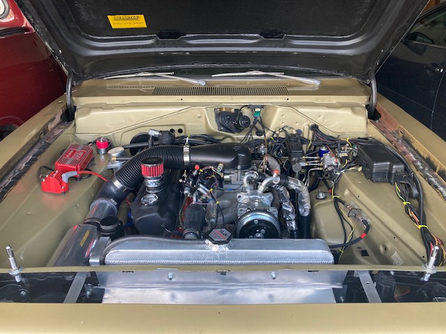

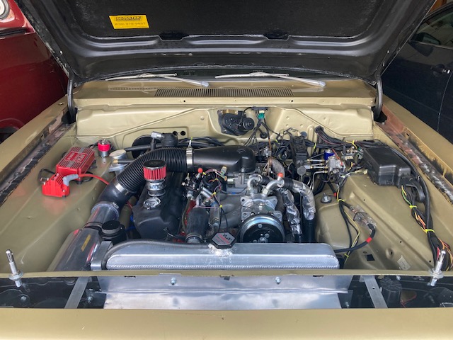

Over the past two months I have parked the 83 D150 and have been daily driving the 68 Barracuda. This has given me the opportunity to do a lot of tuning on the MS 3 Pro MPFI system. The car starts like a modern vehicle, just turn the key and it starts and goes. The motor has 1000 miles on it and I gave it a check up.
Compression from 1 to 6 was: 180, 180, 180, 180, 185, 185 it broke in nicely.
I also adjusted the lash on the roller rockers. I made a few .001 to .002 adjustments but nothing major.
The car gets a lot of attention here around town.
I do not plan to attend any slant six races this year, perhaps next year. I am playing a lot of pickleball, as well as golf, hiking and other ventures.
I have met several other local car crazy guys, a couple of them have really nice Mopars and I do enjoy the 68 Barracuda.
