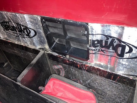

* Added a cab vent, since I changed out the door seals when I re did the truck, it takes a really good slam of the door to get it to close with all the windows up. I got a set of these vents at the pull a part. I installed one of the vents in the rear cab wall behind the driver seat. Photo below. It has helped a lot.
The transmission shifts really smooth thanks for the tips on the transmission fluid. The motor starts easily, pulls fine.

Added a cab vent,
John, I take it you were able to install the vent with the bed on the truck? What are they off of. That is a really good idea.
 Post subject: Re: 83 D-150 Project
PostPosted: Tue May 11, 2021 4:09 pm
Posts: 3864
I did, used a Dremel with a cut off wheel to cut the opening. As the vent mounts from the inside was easy to put in. Not sure what the vent came from.

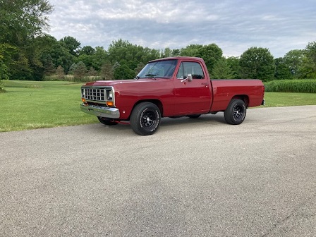

Posts: 3864
The 83 D150 has been back in use as my daily driver for about 6 weeks. I have put 1573 miles on it since the cam and clutch change. M and I have have taken a couple of nice trips in it. One to Middle Fork River Forest Preserve, near Rantoul IL. That location is designated as an International Dark Sky Park,, meaning that there is nearly no manmade light pollution, so it is really dark at night and the stars in the sky are really visible.
This past Tuesday we were in Santa Clause IN at the Holiday World water park with grandkids much fun. The D150 has done fine, no issues. Cruses on the highway just like before the cam change. The only real differences that I notice is with the prior larger cam, when pushing the RPM's through the gears one could feel a surge at 2800 RPM where that cam cam in. The new cam has a bit more push right off of idle then is smooth as the RPMs go up. The idle is certainly smoother and with the new cam. The clutch-transmission is great, shifts nice and smooth like it should.
Today I hooked up the vacuum advance to the distributor. That is about the last thing on the list. Tomorrow I go back on the 68 Barracuda to-do list.

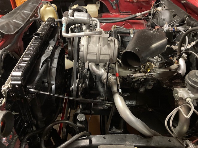

The winter-time do list on the 83 D150 was short this year.

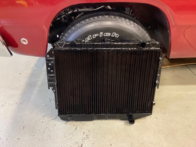

The OE radiator had started seeping at the bottom corners this past summer. I had it re cored locally.
Looks like the shop did a good job, it did take almost three weeks for them to get the
correct size radiator core in. Put in a new 195 thermostat, the hoses were all changed out last year when I pulled the motor
for the cam change so they are still good.

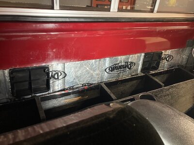

I added one cab vent last winter to help evacuate the air out when closing the doors with the windows closed.
That made a big difference. I had a second vent and I installed it.

I got the cab vents from the pull a part years ago,
It is Chrysler part number 4432752
mine came from an '88 D150 but I bet they were used for several years.
Looks like Dodge put them in the door, I put mine on the back of the cab.
