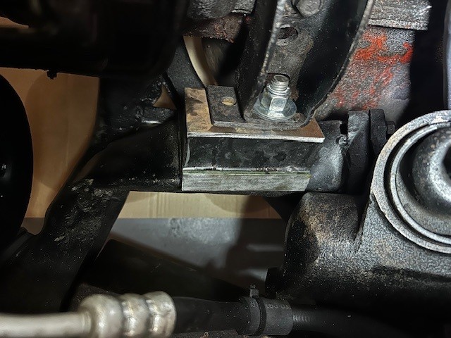

The mounts I got from Johmey, for my 64 Valiant, are the same thickness as the stock rubber mounts. I needed them to raise the oil pan/motor off the "K" member.

I wonder if Dutch might have received the 2469 mounts rather than the 2303-2304 mounts correct for his '64.

PostPosted: Wed Apr 01, 2026 4:05 am
the where 12mm short... so an iron plate is now installed, since the rubber old ones where too fare gone to re-install.
The car is o-kay when driving it, but stationairy the whole car is rattling. I will have to look for rubber ones again since I am definately not gonna drive with this it's a damn waste.
The engine is so extremely smooth, I changed all fluids, from gearbox to dif to engine oil and there is no sign of any wear or metallic residu. The car is mechanicaly extremely well; but this just ruines the whole car...

12mm too short = definitely not the right parts.
nope, and I specificaly asked for the right parts... did cost me about $ 227 parts & shipment and another $80 customs...
Then I needed a mechanic to put them in; which costs about $90 an hour over here... Then they didn't fit so it had to be custom made to get the car even running...
i'm not a mathematician but I do know when something costs me way too much for this crap... The whole ride is ruined and it's probably gonna cost me a lot more time & money to get the car fine again.

But…why didn't you contact Johnny and tell him the parts are wrong?

only way to get them mounted right is with spacers in between..
Were they allowing the engine to sit too low in the K frame? Pan hitting the frame? I will be happy to measure mine and see how tall they are. I know that won't help you but if they are the same as mine then something else is going on. Sorry for your troubles.
PostPosted: Thu Apr 02, 2026 6:29 am
Posts: 17641
Weird. I have used multiple sets of those mounts on my 64 Dart, 66 Valiant and 62 Valiant with no fitment issues. You must have received the wrong ones. They will probably transmit more vibration, which I would not notice since I have bumpier high HP engines.
