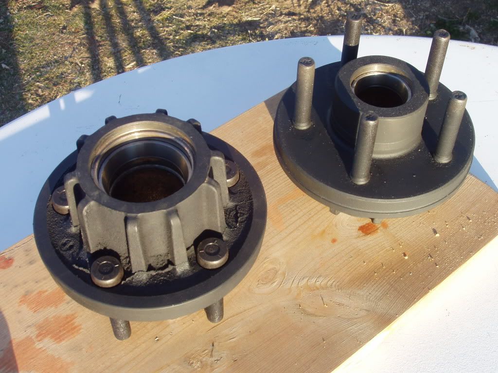

When I talked to a shop about parting them off and touching the snout to fit my 17" wheels, he wasn't much interested in it unless I cut the rotors off first. I have to admit, I kind of drug my feet on it because of that (didn't realize it was over a year of dragging them though :shock: ).
Oh well, I could use the weight loss, and all I spent on it was $2.25 for new hacksaw blade (cut the time on the second one in half). Out of pocket was still less than a six pack. :P

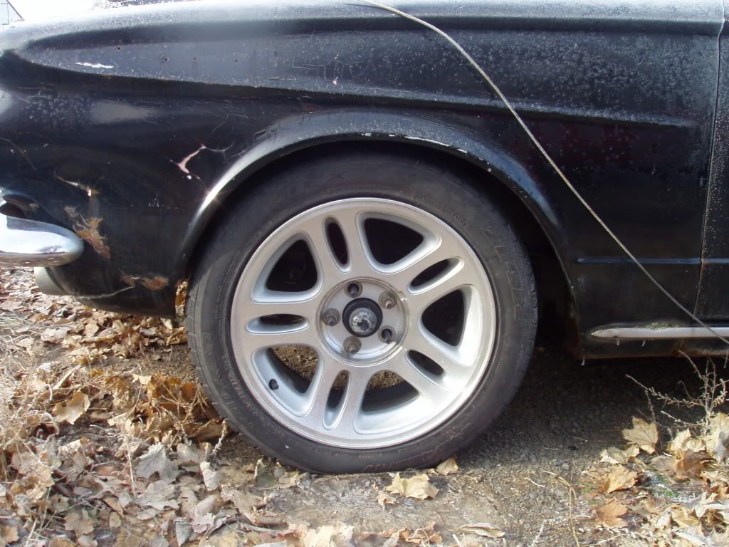

Finally got the hubs done.
Had the shop step the snout to match a Mustang hubs so they would match up to a Mustang rotor and wheel. In the end, the snout didn't need much, but I had it turned to 2.80" for about 1/4" from the wheel flange and then 2.78" from there up (this from memory, need to verify my numbers).
Also, had to step up to aftermarket MP wheel studs as I couldn't find anything OE that was long enough. The stock Mopar rotor/hub seems to be much thicker than any of the latter model hub flanges so everything was short.
Couldn't mock up my brake kit as I ran into an interference between the adapter and hub, so that will have to wait, but I was able to finally get the wheels off the ground and on the car. Not sure the 17x8 wheels are going to work in front though, they look awful tight. Didn't turn the wheels yet, so we will see. :shock:
