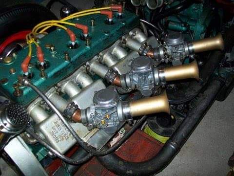

I will agree the Slant 6 and the Flathead 6 are 2 different animals.
I.would agree they would perform optimally at 2200 to 2700 cruising speeds all day long. Some flathead 6 owners cruise at 3000 rpm on highway.
Stock they are rated at 3600 rpm, and will perform in the 3200 rpm band if needed.
Chrysler would routinely run these engines for 50 hours at 3600 rpm for tests during the production years
You want these engines to breath snd perform better, same stuff as slant 6 in theory.
Yes a flathead can be made to rev to 5500 rpm, would they run like that all day of course not. A 225 slant 6 would perform better than L head for sustained RPM perhaps, although a 225 has a 4 1/8 stroke and is an undersquare engine, so piston speed is a concern.
Flatheads can certainly be made to perform, to the degree of a slant 6, no as they certainly are a different movie.
