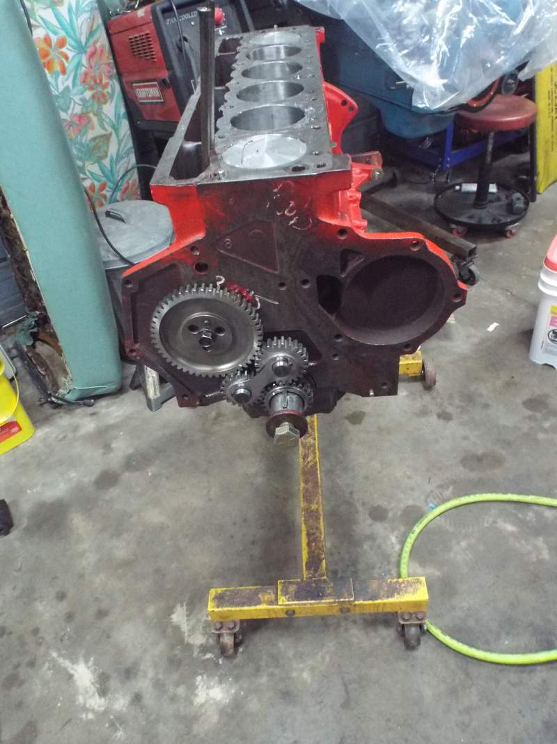

Not at all Greg. It's all relative. It's a CHEAP (under 20 bucks) C.A.T. gear drive for a 440. After seeing people machine spacers for the cam gear to space it out since the cam gear is the only thing different, I got to thinking there must be a better way to align the gears. SO I sat there looking and thinking on it. For a couple of hours. Fiddling with gears, just messin around gettin familiar with it. It fits pretty much as is, but the crank gear sits out too far barely meshing with the idler gears. This is why people were making spacers. Suddenly it hit me. I pried the crank gear back off and flipped it over backwards and knocked it back on. It lined up perfect backwards, so I remarked it and there it is. I cannot STAND how the dual idler system "rocks" back and forth when you turn the engine one way, then the other. It's a problem every single dual idler system has and it allows the crank to move several degrees independent of the cam gear. I don't like that. So I plan to either convert the gear drive to a single, fixed idler, OR run a Rollmaster/JP timing chain set. That's what I have for my "for now" motor I am working on now. I've already figured out how to make this a single, fixed idler setup and when I do it, I'll post here so yall can see how I did it. I'm just going to have to be very confident that it will not fail when I am done, in order to let it fly, because for ME, being on a fixed and very limited income, this isn't a cheap hobby.

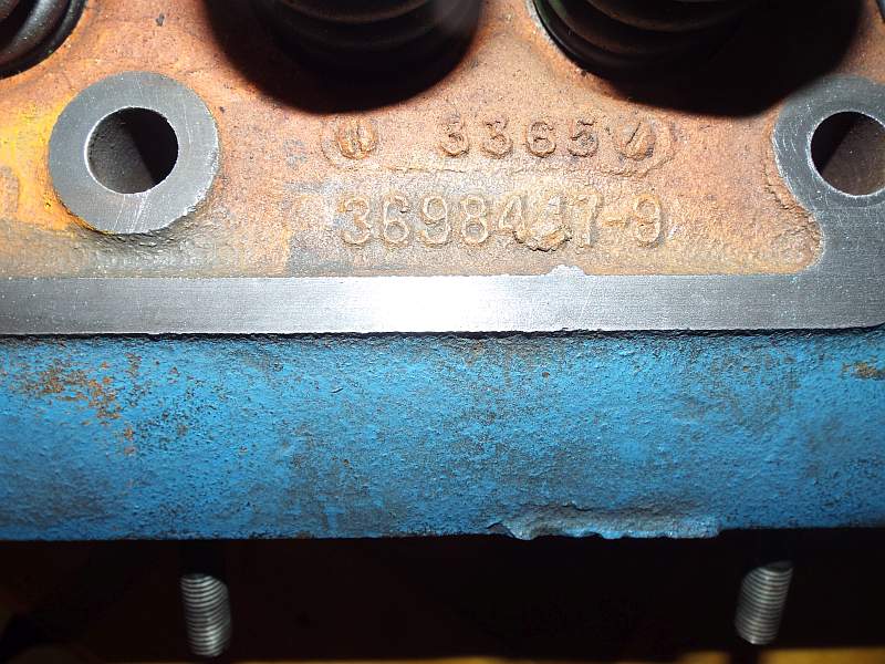

Ok here it bees. Charrlie_S, I took the thickness measurement you asked for. I have not CC'd it yet, as it's pretty cold here tonight, so I'll do that tomorrow. I measured first, an unmilled open chamber "revised" chamber head and it's thickness from the valve cover rail to the deck is 3.614". The closed chamber head in the same place measures 3.625", so it is actually a little thicker. So, I would assume the closed chamber has never been milled. Certainly not milled from open to closed, which will be evident in the next pictures.
First, the casting number. That 2nd "4" is a 4, it's just a bad angle and the flash helped wash it out. Maybe that's a date code above it, I don't know.
