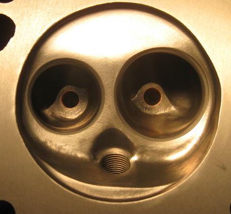

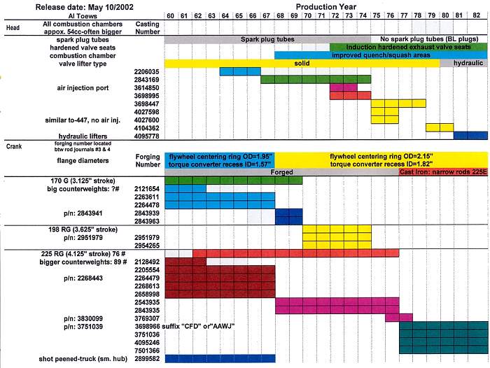

So which era of cylinder heads are these numbers coming from? There is a least 4 different castings done over the years and I have a head from each era.
1) I have a 1963 head with the first generation of the chamber design. The ports neatly match the gasket and the runners have a nice flow to the valves. This may be a fluke, or the myth that yellow engines are better then red engines is true.
2) I have a version from 1974, but it is currently setting on top of the engine of our Duster. So I can't say how well it was casted.
3) I have a couple of heads from the 1976 - 1979 era. The runners need to be gasket matched and there is a definite difference in the port runners from the '63 head.
4) I have a head from 1980 and beyond. Once again they need to be gasket matched and the runners are designed differently from the others.
There must be a reason for the port runner changes. Is one era better then another?

I think my head is the "169" head and that is what Mike asked me to send for porting if I had one.
PostPosted: Sun Feb 26, 2023 6:13 pm
Posts: 2756
169 is a drool tube head, 67 to 74, with the chamber wall stood up more vertical than the earlier head.
On the spark plug side.
That chamber shape is better, I agree with Mike.
