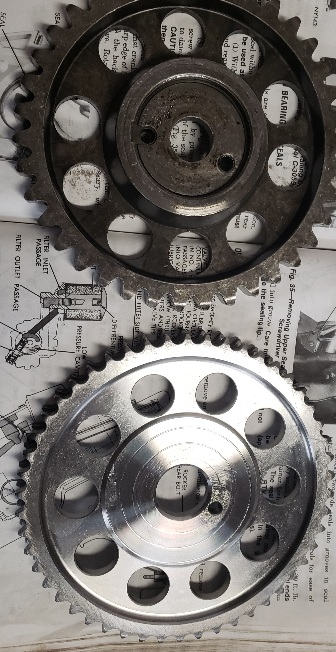

Was going to install the new rollmaster timing chain and the cam sprocket doesn't seem right. Factory has a boss that centers the gear on the cam. New gear has nothing. Am I missing something here? Nothing to center the new cam gear on the cam. Nothing to hold it in the right position forward and aft.
Eta: Does the chain center the cam gear?

No, Sum-Ting-Wong, chain can't center it. Part# on that T-kit?

The center holes look different sizes too?

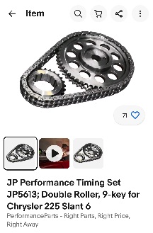

https://www.ebay.com/itm/263577823687?m ... media=COPY

Nope, It looks like you have the wrong gear. Or at least one that was not finished with the recess for the cam. Center hole still looks large to me?

Picture shows the rim that isn't there. May just have to buy another. I'll wait till Monday to see if they respond. It is outside the return period so don't blame them if they don't accept a return.

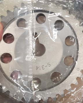

Ordered another cam chain set and the cam gear is slotted. Don't think I can use a button to adjust degree with this. The picture looked like the stock gear with 2 holes. Does anyone know of a place to get the right cam gear?

What happened to your original double roller set? The new one looks to be the stock type gear? Wouldn’t the company send you the correct set?

The double roller set had the wrong cam gear. Think it was for a big block. They did accept a return.
I would install this set and see how far off it is but then wouldn't feel right returning it. Was going to drill out the cam pin hole and use a bushing to degree the cam. Don't think that is possible with this slotted cam gear.

Go to Rock auto and lock it up on there. I don't like the slotted one. I think I got my last set at Auto Zone and it was correct. ( No slot)

Found this: https://www.ebay.com/itm/266459928542?m ... media=COPY
Will a sealed power gear work with a Cloyes chain? One of the sets was bought as pieces and I could return the cam gear. Use the Cloyes chain and crank gear.
