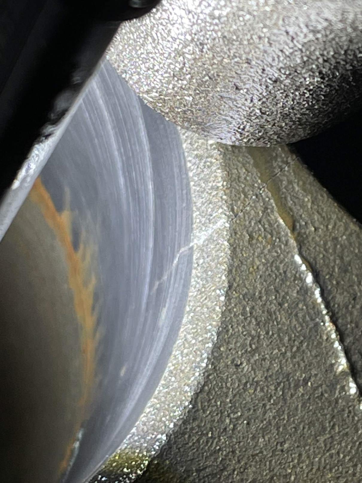

Looking forward to seeing everyone. Current situation: Real quick like block swap...
PostPosted: Wed Sep 11, 2024 6:47 am
Posts: 17634
Oop. Good luck with the quick swap!
PostPosted: Wed Sep 11, 2024 7:23 am
Posts: 10406
I have had that same bout of crack back in the day :shock:
PostPosted: Wed Sep 11, 2024 8:57 am
Posts: 147
Location: Owasso OK
Car Model: SDRA Dragster
Fortunately I already had another block bored and honed. Just needed to do some final work on it and now it's ready to reassemble. Hording pays off sometimes.
