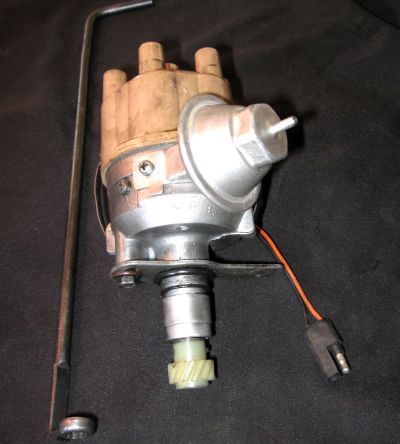

The distributor that I'll be using in this conversion (part # 3656763) has a black wire and an orange wire. Doesn't it stand to reason that everyone who has done this conversion using an orange and black wire Mopar distributor ended up with the same result after their trial and error?
The two options are:
1. Orange to W / Black to G
2. Black to W / Orange to G
As I mentioned earlier, I have a 318, but an image search shows me that slant-6 distributors also have an orange and a black wire - link, or at least some of them do.
So have any of you who have done this conversion done it with an orange and black wire distributor, and if so, was #1 or #2 the correct way to wire the distributor to the HEI module in your experience?

The distributor's pickup in that diagram has wires labeled "Black" and "White/Black" (which is different than my distributor; mine has an orange wire and a black wire). Then those black and white/black wires in the diagram splice into an orange wire and a dark blue wire. The orange wire is connected to the HEI module's "W" terminal.
Has anyone here done an HEI conversion in which the orange wire is not connected to the HEI module's "W" terminal?
PostPosted: Sun Aug 11, 2013 5:07 pm
Posts: 9094
Don't worry about the color of the wires. The plug on the distributer has a male and a female connector. The male pin goes to the "W" terminal on the module.
