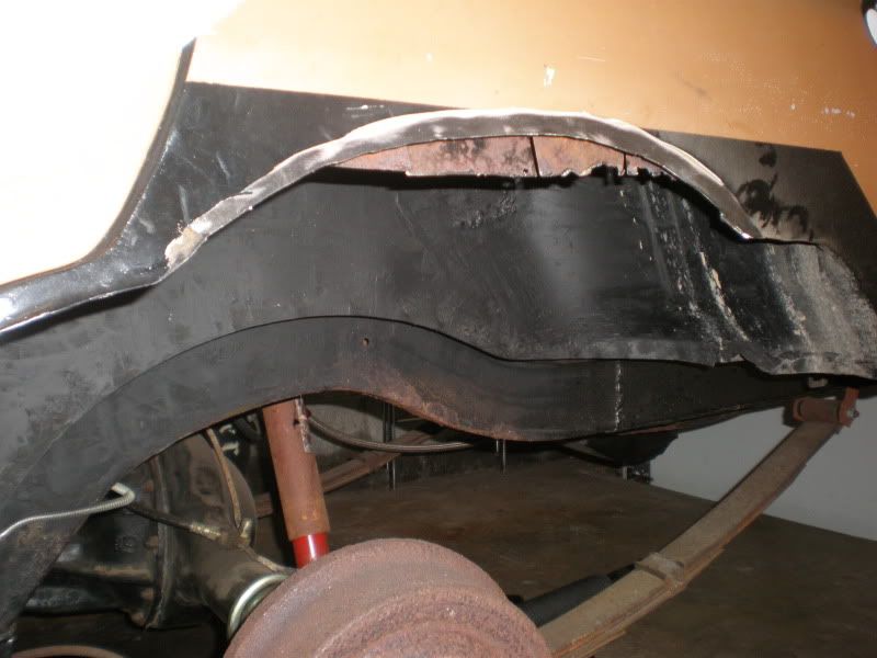

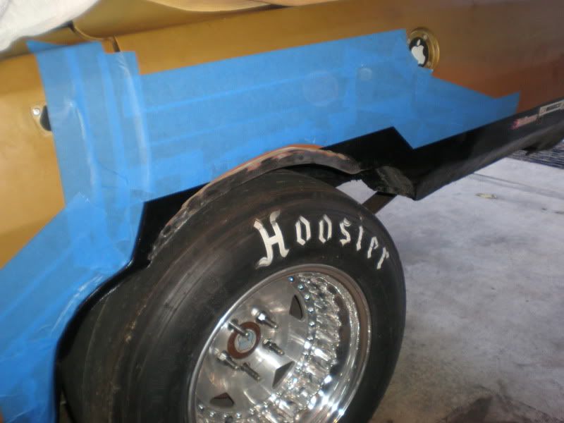

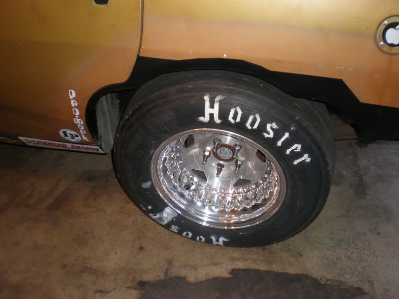

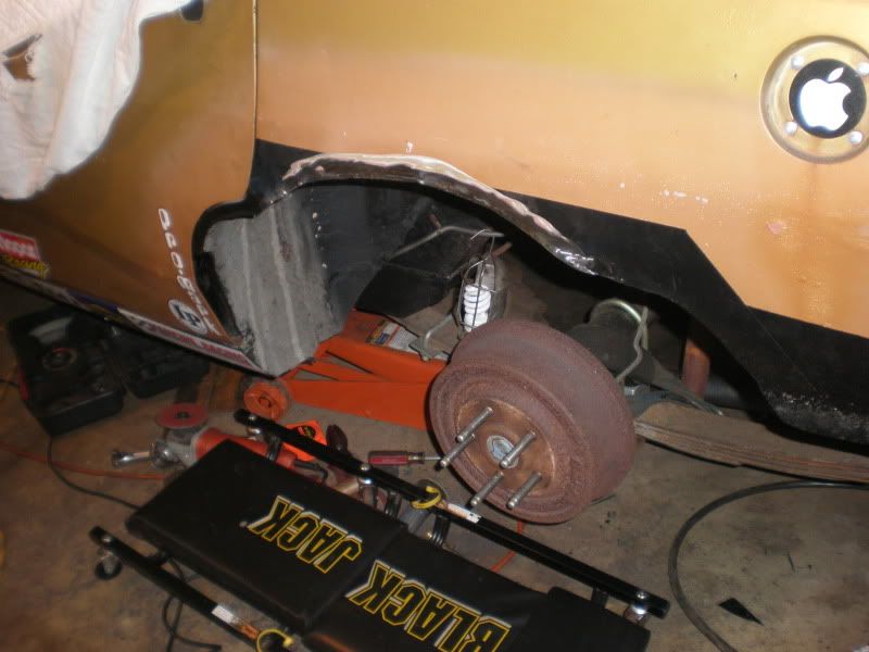

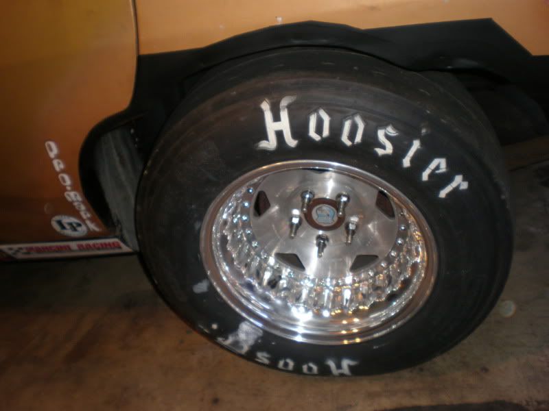

I got the LR Wheelhouse raduised to the wheel / Tire so Now it kinda looks like the right side.
I ended up getting 1# of metal out of the car by doing so :-)
Now at 318.5# lost since November 2010.

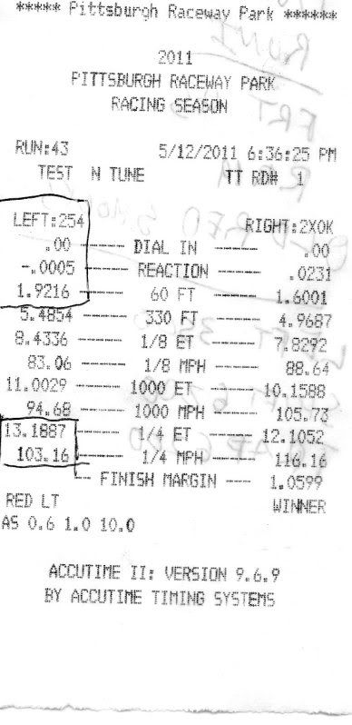

To answer an Eariler Question, I have 27X10.5-15 Rear Slicks,
NOT 29" tall slicks,
Thursday Wnet to TNT, Guys at the track said Altitude air was 2800'
Only made one Run, and Was called up & sitting in Lanes for run #2 before some kinda oildown stopped things for a bit, then Race control sent us back to the trailers then it poured :-(
Anyway I got a raincheck on that to use for another time and I ran a 13.18@103.16
Typically Runs 2, 3 go faster than the first run cold off the trailer, so This is promising for 12's soon :)
One More TNT session Here (weather Pending) before Maryland
Pic Of timeslip - It's weird to see a "perfect" reaction time on the scoreboard ('cause it only displays thousandths) with a red bulb :shock:
