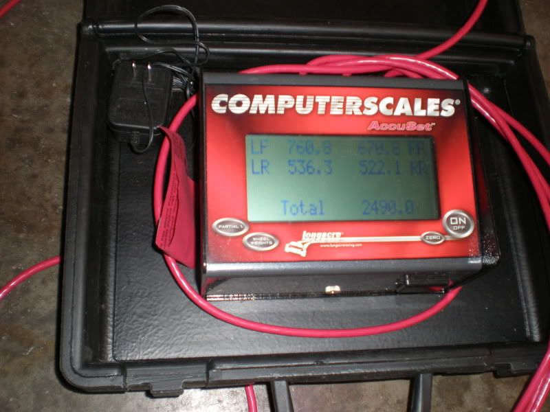

While at Lou's, I got a chance to Re- Weigh Ruster Post Diet and (DRUM ROLL PLEASE)
Here are the results..
I had Calculated each and every bit of Crap I cut off ruster to be 327.5 # Lighter than Last Year So Last year the car was 2575# - 327=2248#
Some times I did not weigh some of the stuff I added :-( Like Air inkake, Grille covers etc....
So.. After the Biggest loser Challenge Slant six Version the Final Weigh in was: 2268#
And With 222#'s of Driver and All racing Gear: 2490#
So actual Weight Saving was 307#, 20 # off of my Calculations.

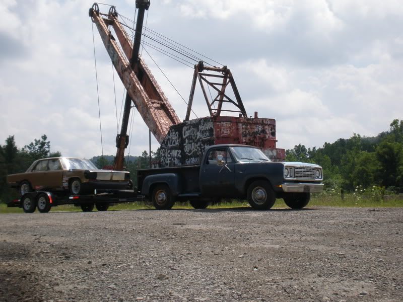

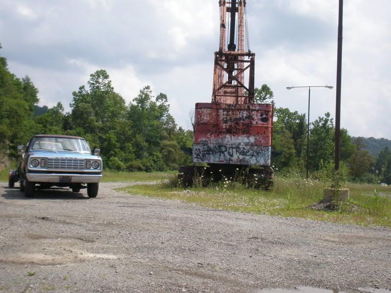

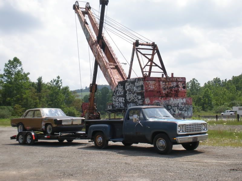

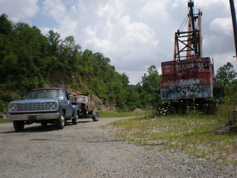

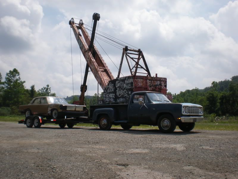

Also Stopped at this Old Steam Shovel 40 Miles south of The 'Burgh for some Fun shots with Rusty Valiant, Rusty Truck, and Rusty/ Graffiti Steam Shovel :-)
