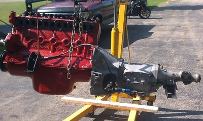

Does anyone know how reliable and well hydraulic release bearings do work?
How about this setup would this work?
PostPosted: Sat Jul 14, 2018 1:37 pm
Posts: 3866
One advantage to the external slave cylinder is you
use a conventional throw out bearing.
IIRC ‘87 D150’s used a set up like that.
Concerning reliability, I have a ‘96 GMC Sonoma with
+200K miles with a hydraulic clutch and zero
maintenance on the hydraulic clutch system.
So they can be troublefree, there are issues with
the aftermarket installs, probably due to the
custom installation...

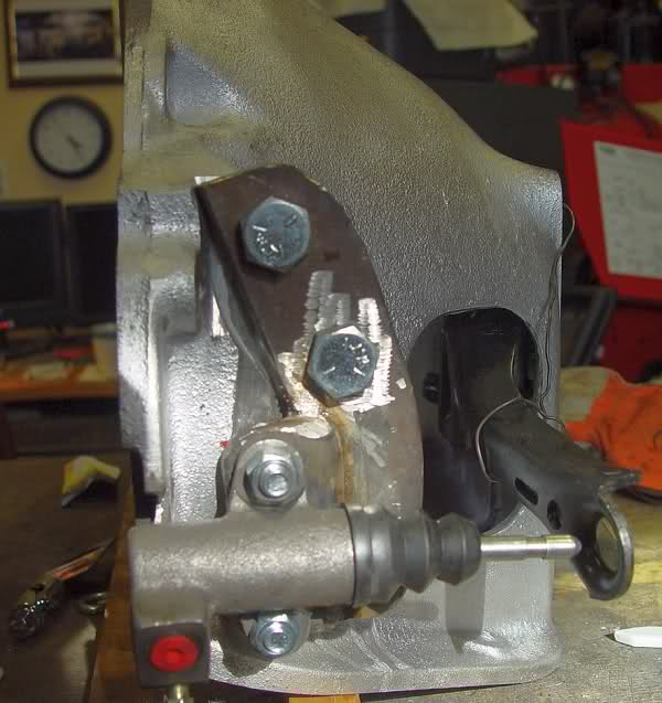

Turbo Toad on here used this setup. Not sure how well it worked but it moves the slave cylinder back as a puller.
PostPosted: Sat Jul 14, 2018 4:21 pm
Posts: 107
Car Model: 1955 Dodge Truck
That looks promising and less money.
If i have the room could fo this route.
All in the planning stage right now.
The question is can I shorten the long truck type shifter fork to gain clearance?

PostPosted: Sat Jul 14, 2018 5:14 pm
If it's a slot type fork, you can use a car fork which is another 3/4" shorter... You can cut and weld a fork, but reinforce it well as
they tend to bend or snap under heavy force or heavy clutch cover levers depending on the type of clutch you use
(diaphragm doesn't take much... but the 9 1/4" B&B does need some leverage to actuate compared to the 10" and diaphragm style clutches....)...
shorter will mean less leverage so the cylinder will need to exert more force to do the same job compared to the longer stock fork, FYI...
