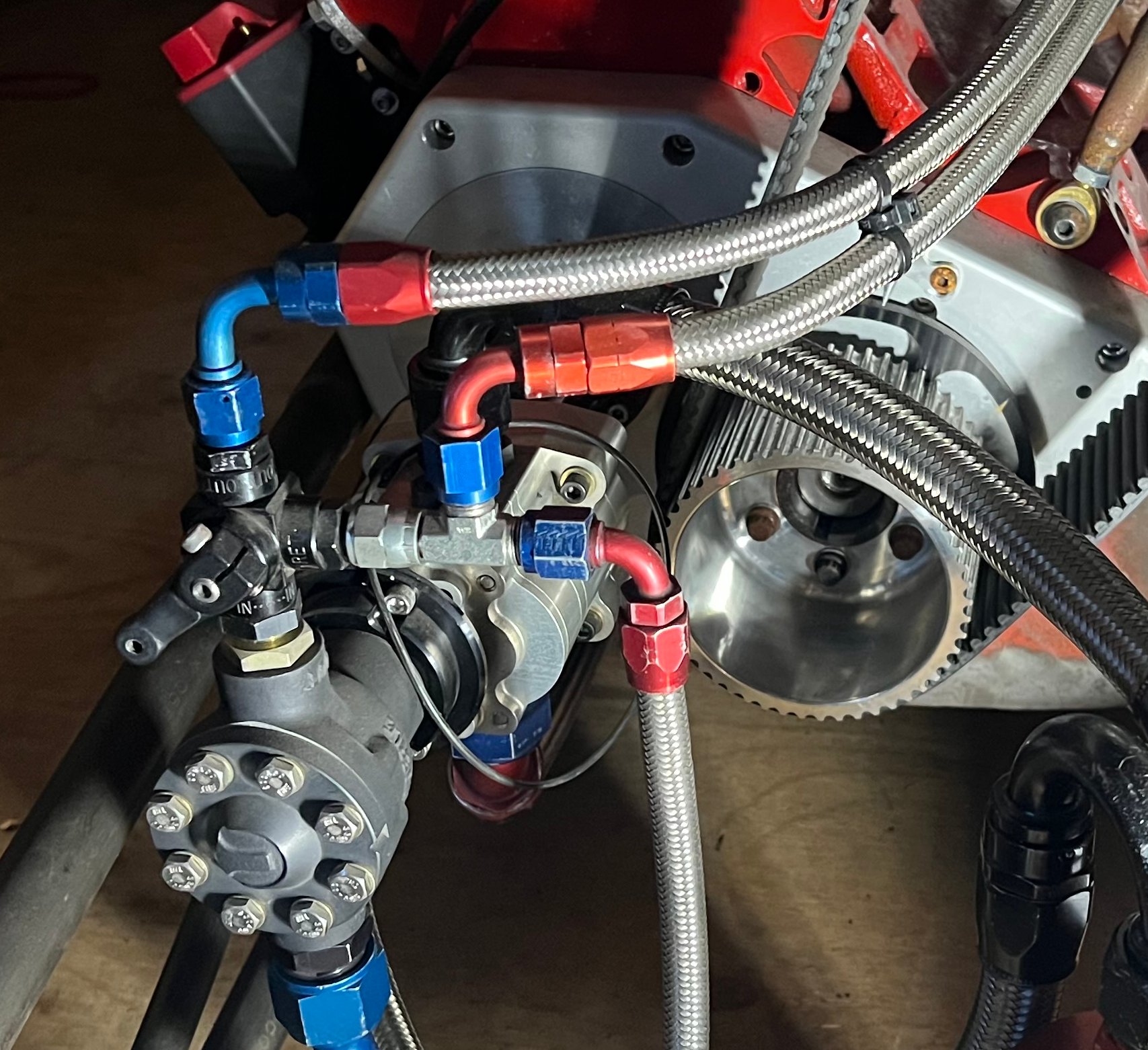

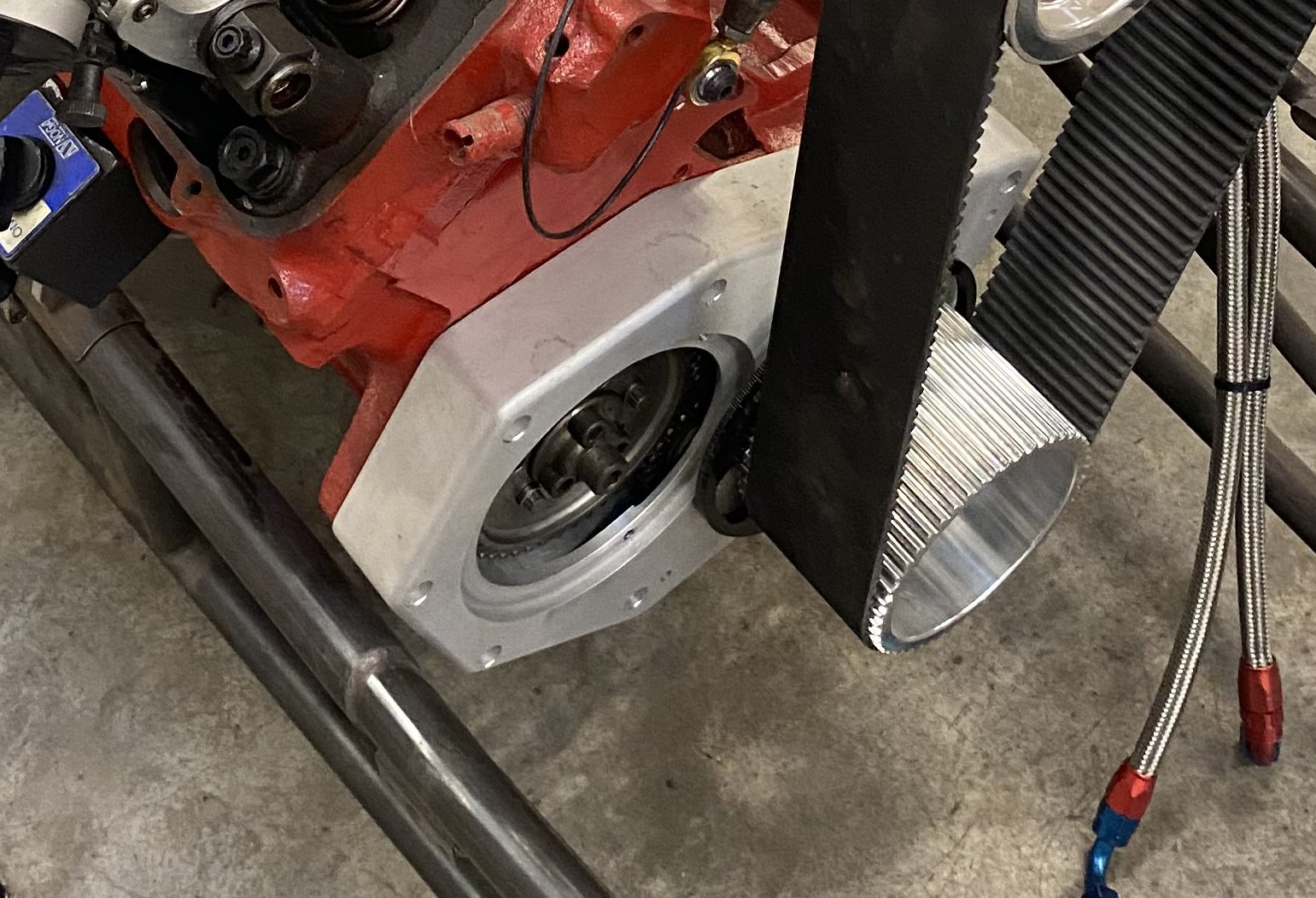

I got a bronze gear for the Magneto. I also have bronze for the oil pump, though I didn't end up using the stock location pump, rather a front cam drive Daley that runs the Fuel pump as well.
CJ
Do you have a picture of your cam drive set up?

They aren't great, but these I had on my phone.
