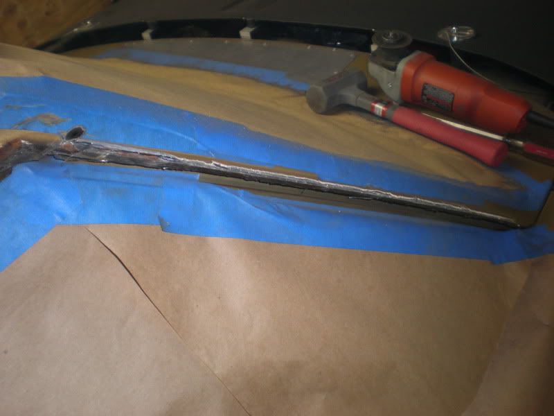

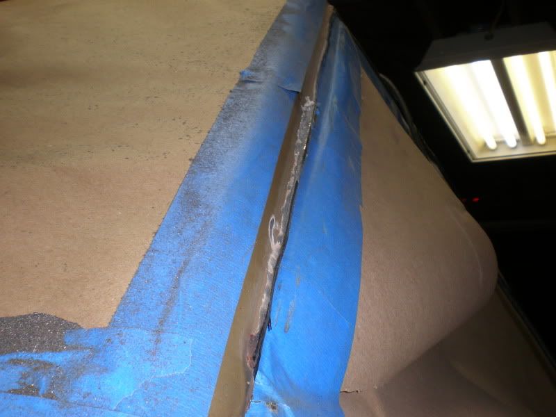

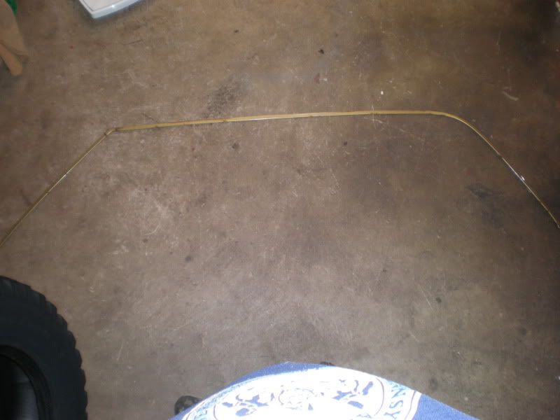

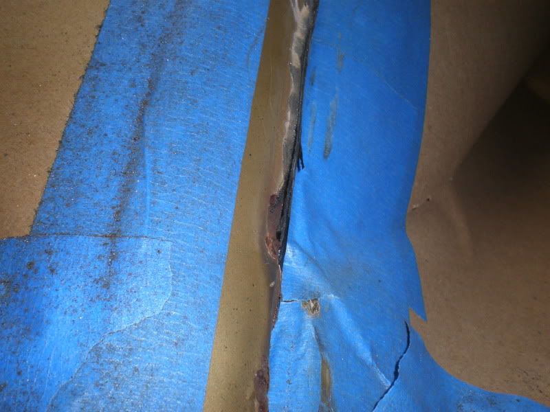

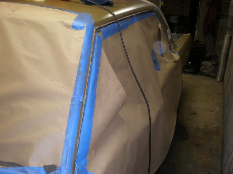

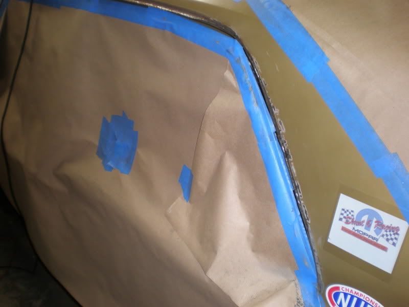

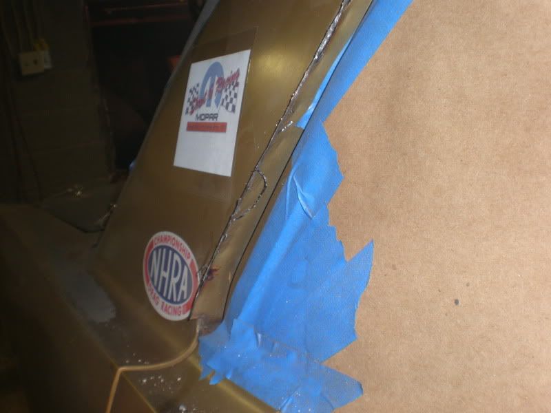

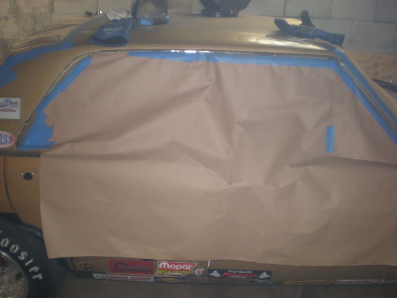

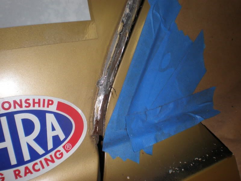

Killing 2 Birds with one Stone So to Speak with this Mod:
I Am getting rid of the Rain Channels above the doors and Pretty Much Flush welding the Roof to the outer Door Frames(A, and C Pillars) I will get rid of 2.5#'s of stuff that I dont need while improving the Aero a slight amount as well.
Pics:

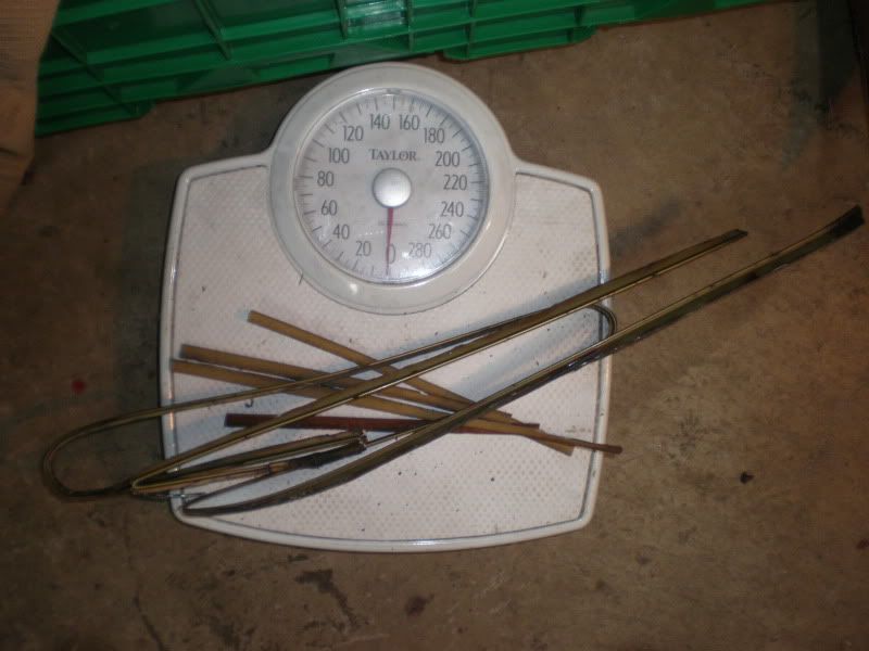

2.5# of sealer and metal off ruster :-)
at Last check car weight was 2250#
- 2.5#
______
Now 2247.5#
PostPosted: Wed Nov 16, 2011 7:42 pm
Posts: 1394
Location: long beach ca
And I thought Seymoure and I were nuts,,,He is worse than me,but you are getting very close to me.I actually sweep up the grinding metal and weigh it.If just removeing the gutter rails only picks up a .001 its something and makes ya feel real good.I look at my car and try to think where the air is going to hit it to slow me down.Alot of work for little gains makes me feel good.Guzzi Mark

You guys are great. I've been dreaming about cutting those rails off for 10 yrs, but haven't had the guts (or the Ruster) to do it...

I cut just the back part off that would catch air.My car didnt have them on the front from the top of piller down.We can get 250 to 300 hp NA to the rear wheels,,,Period.Any weight saveings or areo is where we gotta go to go fast in my opinion.Think I have kinda proven this. Guzzi Mark

Cut off 3 pounds of metal, add 4 pounds of welding rod. :D
Yikes - I dont think I added that much... Besides Most of it got ground off flat anyway.
I think I will be removing the rear Door Frames as well and Just using aluminum sheet to fasten the Windows to The car - THat will Prolly Take out ~20# total and add some more aero :-)
More updates to come fo' sho'
