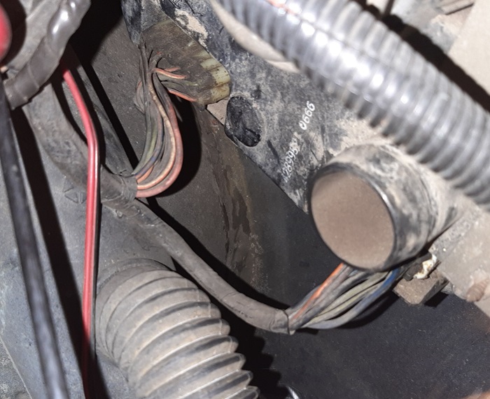

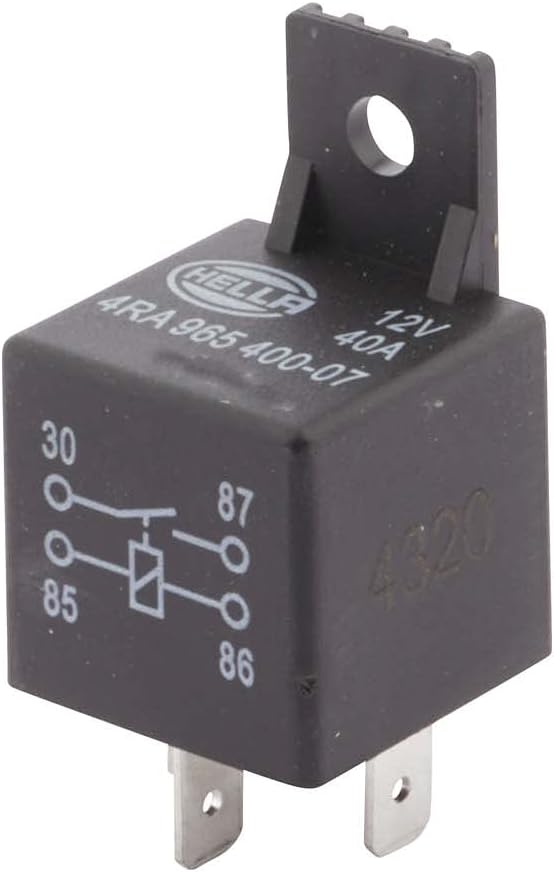

Hi guys,
With the help from the guide I’ve installed the HEI to get rid of the leanburn. However, I’m pretty sure I made a mistake wiring the relay, since it will only run without the relay.
I’ve used a Hella 4RA 965 400-071 relais.
30 – powered directly by battery with 15amp fuse.
85 – ground
86 – To coil +
87 – To coil +
I guess 86 should go somewhere else. I’ve got a few pictures from the spark control box behind the battery. Does anyone know which cable I should connect to 86? I can't use the wire from the ballast resistor since the leanburn system did no longer use the ballast resistor.

30: load circuit in, you've got this right.
85: trigger circuit ground, you've got this right.
86: trigger circuit feed, you've got this wrong (should go to ignition-switched +12v)
87: load circuit out
