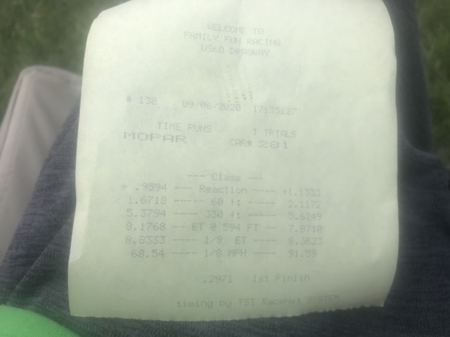

Photo is a little hard to read.
60 ft: 1.6718
ET: 8.8333
MPH: 68.54

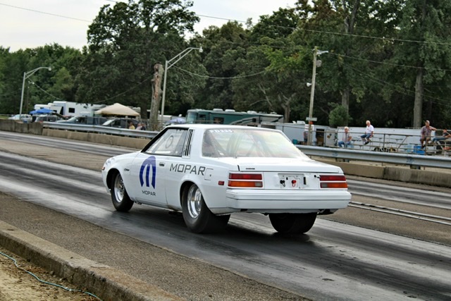

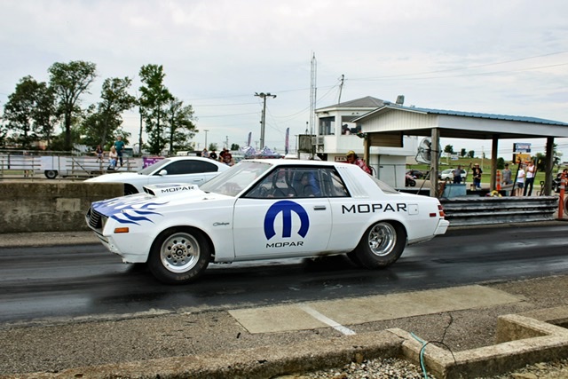

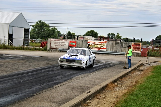

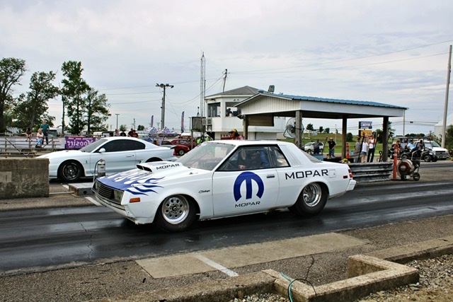

There was a young photographer at the track handing out cards. He got four shots of my one and only pass. I just bought the photos from him. I’m his second customer, so I gave him a little extra. :wink:
I’m gonna go ahead and post more proof that I ain’t just funnin’ about makin’ that pass.
