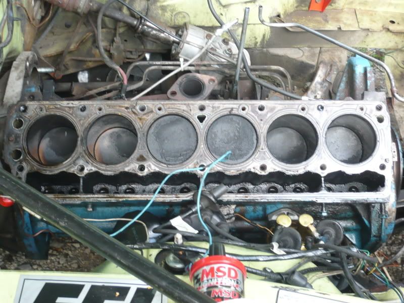

here is todays progress:

As it turns out the only gaskets I have are head, valve cover and fuel pump. Almost all my other leftovers are small block. I have all the bottom end hard parts. Go find a Fel Pro KS2103 and we'll be in business.

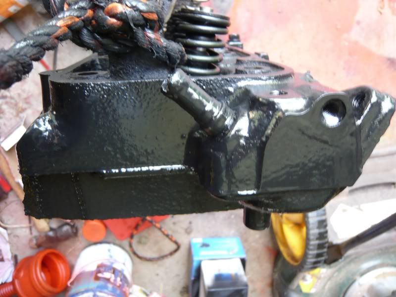

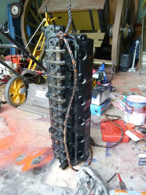

i woudl rather just have help getting this one pulled and on its way to ceej's house. the pistons look good and so does most of the head. i would like to clean the valves but i don't know if i will dammage anything so i am leaving them alone. i have the head painted, it was hard to mask off the rocker arm and stuff but i rigged up carboard and printer paper with masking tape and gave it many good coats of gloss black. it looks awesome! :D

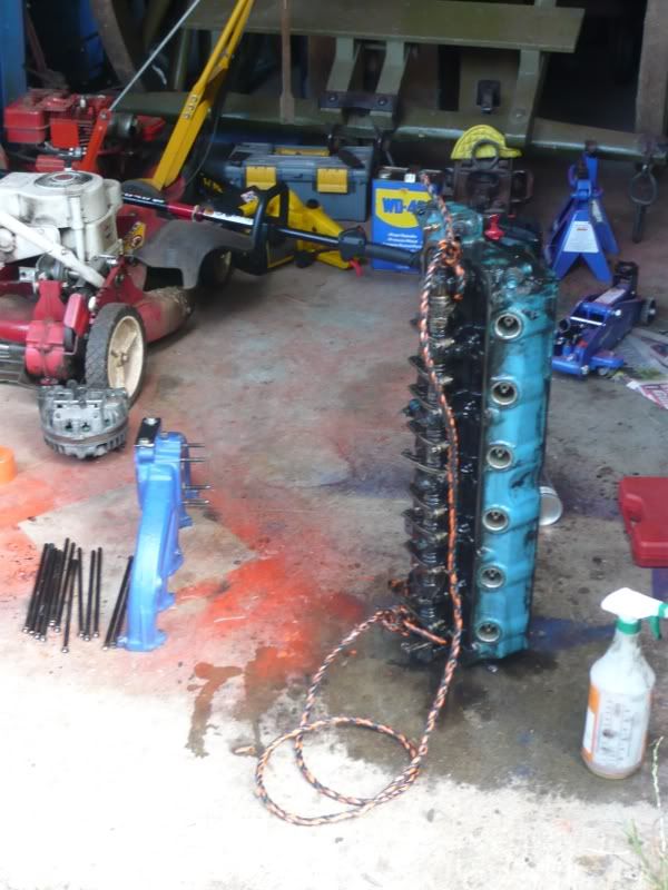

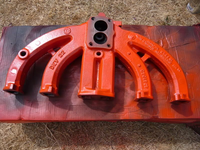

today i pulled the fuel pump and dizzy. i finished the paint on the intake manifold and it looks good. kinda weird that i ended up using 3 diff colors of orange on the parts since i am color blind i only noticed it when i had all the parts together and in good light. i had so much greese and oil mixed in with the hair product (dax) in my hair that i had to give my self a haircut to remove it all. even dish soap or bronners soap wouldn't cut it.

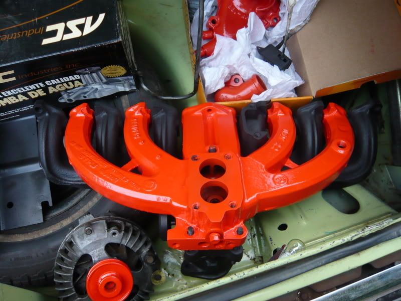

you can see the 3 diff shades of orange in this picture, but it will still look awesome with a black block & head.

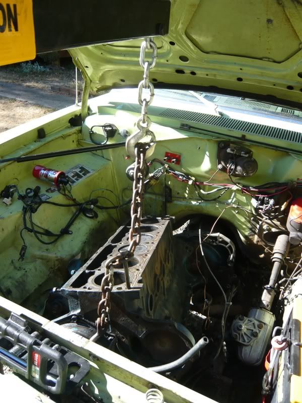

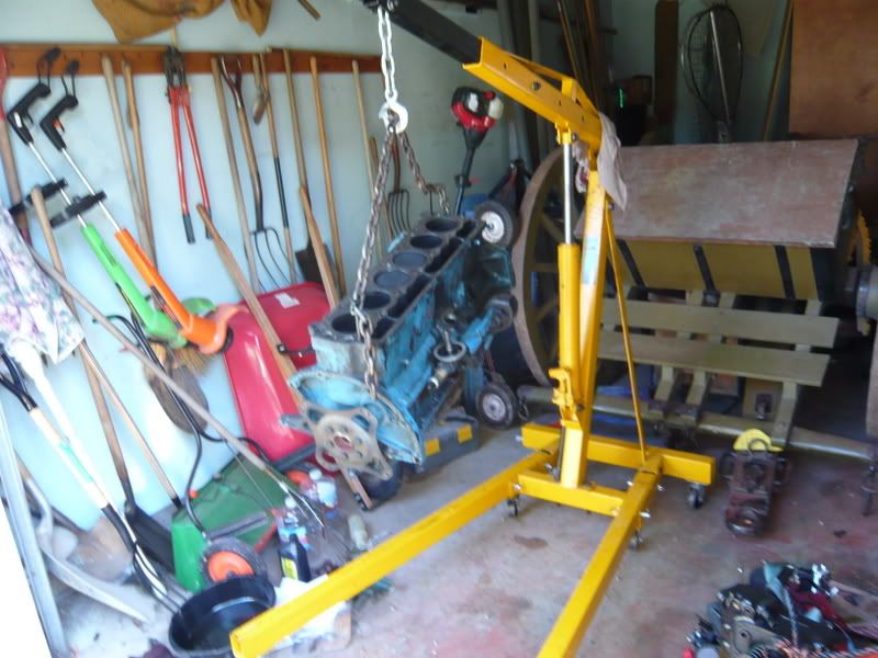

well a good friend was nice enough to loan me his shop crane! thanks dood u rock :wink: ! it's out! wow my frist engine pull! hopefully the last! i was amazed in how easy it was. i did call for help a few times to be honest :oops: but yeah! next is getting it cleaned up and secure in the truck for transport! i'll keep ya guys posted!

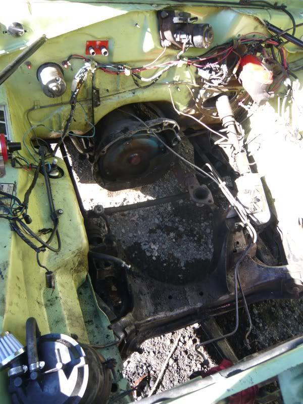

well by some miracle, i actually had enough to get a complete engine gasket kit. woo ho! i have been scrubbing the engine bay and the stock paint; fenders and firewall looks pretty good. would it be a good idea to shoot some clear coat on it to protect it? tomorrow i am painting the engine mounts and k-member and stuff that i don't know the names for.

If the engine compartment paint is in good shape just clean it and wax it.
