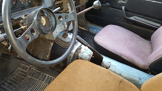

Cut trans tunnel near OEM for the RX7 trans stick.
Installed hurst shifter for the 833 lots of room and no restrictions on movements.
Now it needs to be boxed into the tunnel.
I need to pull the dash and close in the firewall too.

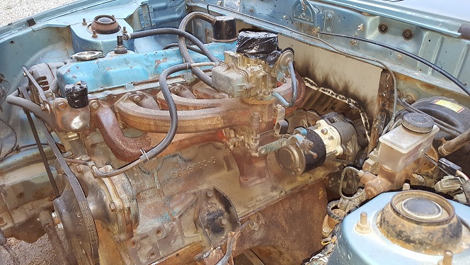

Hey all, Thanx for all the "Thumbs Up", on this oddball of a project, I'm still scratching my head on the whole idea.
So a bit of an update, trans and engine are mounted in, all of the firewall cutting had to be repaired, and it is now completed, there are some floor patches to repair, and as well some minor unibody reinforcements, as well as the tunnel around the A833 Hurst shifter.
My biggest challenge and hurdle, will be designing and fabbing up the clutch hydraulics, and have already decided no hydro release bearing will be used in this.
I'm going clutch master cyl and slave cyl set-up.
I do have already the clutch pedal and MC for the stock RX7, this is a bit small for the job, but the pedal is setup with stops and all. So stay tuned, or add in your ideas or proven methods, there will not be any Z bar and linkages used on this, I have considered a cable setup, but have no idea what and if it would be serious option.
Here's a pics of the firewall closed and welded in....

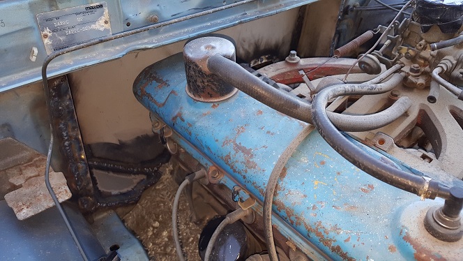

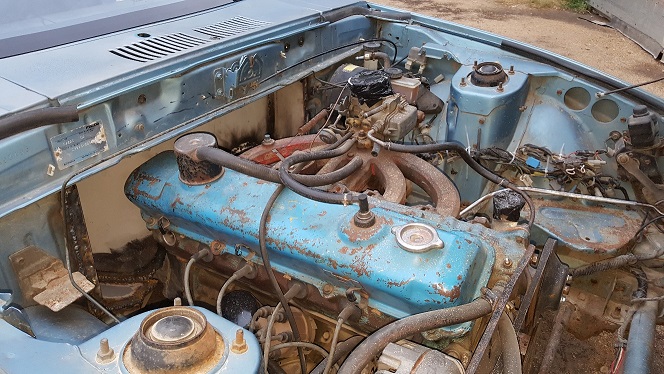

sheet metal work is about completed.
Lots more to go, but here are a few pics, of the "Little Bastard"....

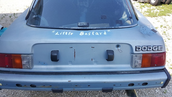

The "Little Bastard", RX7 rebadged to a Dodge............
