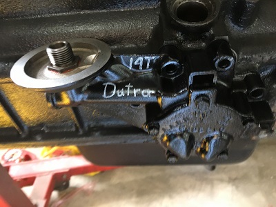

Got my pump from Doug painted and mounted on may back up motor. it has a much better head and a little bigger cam. As soon as the Mason Dixon race is done I will get the engine swapped and give this a whirl! :D

Very interesting. Is the idea that if there's an imperfection on one tooth of the cam gear, that any damage it does will be equally distributed over all oil pump gear teeth instead of chewing away at just one tooth? Or is it an attempt to get multiple teeth engaged at the same time?
Also, does this just press onto an existing oil pump, or are modifications / spacers / etc needed to change the shaft alignment?
