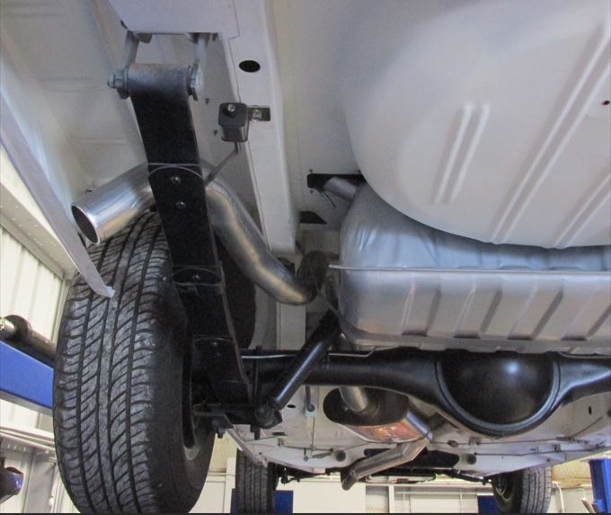

Posts: 2761
Hey Greg, this is how we ran my Lancer tail pipe.
PostPosted: Thu Jan 04, 2024 4:35 am
Posts: 10454
Thanks, Stan, That is looking good.

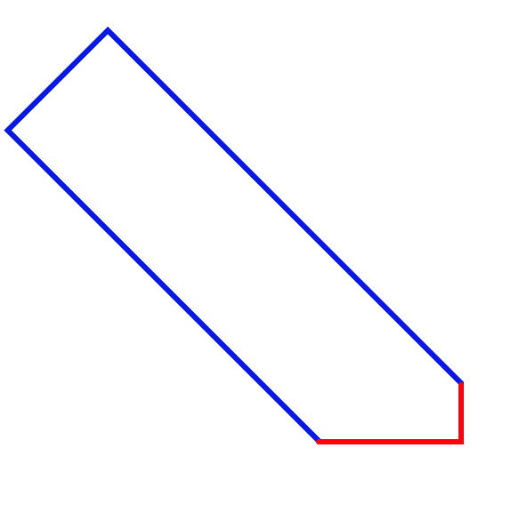

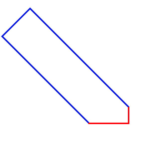

I always like a tail spout pointing 90⁰ down
Might wanna rethink that a little. A down-discharge exhaust (90°, straight down) makes it easy for exhaust to pool under/around the car when it's standing still and there's even the lightest breeze in the wrong direction. If you have at least some horizontal aspect to the discharge angle, you're actively blowing the exhaust away from the car, so at least it's not as concentrated if it does pool. You can have your cake and eat it too: 45° down, then a horizontal slash cut starting at the outermost/uppermost point of the end of the spout, then a vertical cut chopping off about 3/4" of the outermost/uppermost part of the end of the spout. Very tidy and functional. Crude side view:
I am not sure if I understand all of that from the crude side view, but definitely, some considerations are to be made, thank you.
