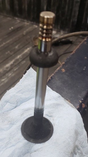

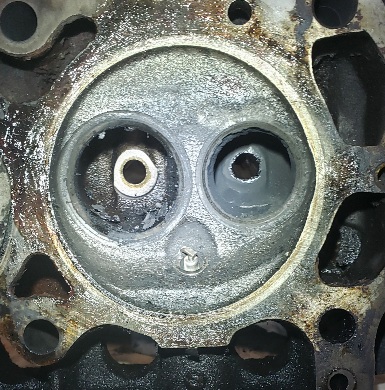

#6 exhaust valve and combustion chamber. I didn't take more pictures but can if you are interested. Had trouble getting a travel indicator on the valve but I can feel enough shake that it is out of spec. Valve seals looked better than I thought they would. Going to try to get this to the machine shop tomorrow.

I dont care how those seals "felt" tehyre cheap, replace them
that exhaust guide is TOAST

Is it best to take the head in with the valves in? Remove the manifold studs? This is new to me.
Guessing put the main caps on the block, take the pistons with rods, and head in. Lay the crank down in the back of the Ramcharger with the block and head?
The 87 Ramcharger is all I have to haul the parts in.
PostPosted: Fri Jan 26, 2024 3:40 am
Posts: 3292
Yeah definitely take the valves and springs and keepers in.
They'll need to reface the valves and inspect them for replacement if needed.
PostPosted: Fri Jan 26, 2024 6:52 am
Posts: 9499
Lower row of intake studs need removed to plane the head.
