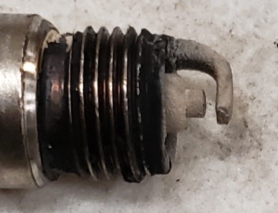

Posting an update. Pulled the spark plugs to squirt in some berryman b12 and soak the rings. Before the plugs were black from oil. Today they are whightish grey.
Don't think it is burning near as much oil as before.
Replaced the valve cover gasket, sender, and oil pump cover o ring. Still using or leaking oil. If it is leaking I don't know where. May replace front cover, seal and pan gasket.
Would be easier to get to with the motor out though. Where else would it leak?
Had the girlfriend rev the motor and laid underneath for a while. Don't see anything leaking.
Picture of spark plugs. They were black before. Have new plugs, cap, and rotor to put in.

And looking at the pictures of your sparkplugs,
Those plug’s don’t show excess oil burning.
If you are still using a quart every 100 miles it is leaking out.
