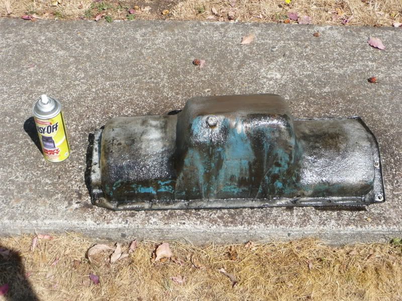

I know your trigger happy with the paint but may I suggest - get it out of the pulley groove or else it may ruin the belt or at least cause it to slip.

if that is original paint or an acrylic 1 step, don`t put clear on it might lift the old paint.

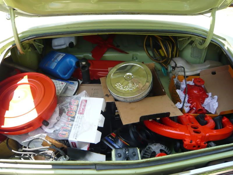

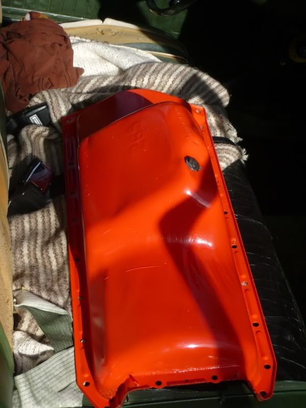

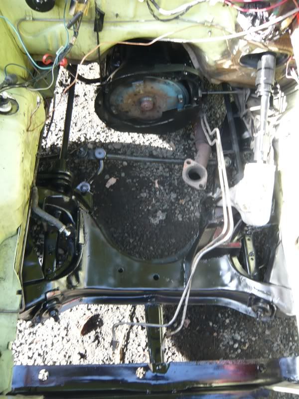

after josh and terrylittlejohn's advice i am only going to wash and wax the stock paint. here is the k-member and other parts all painted up pretty.
i also took advice from my friend and mentor ceej about using oven cleaner. i think it was in on of his posts. it seems to be cleaning up that nasty oil pan really nice and quick. i used my autozone credit to get my a nice elderbrock air cleaner, so my orange super six one is up for grabs (THOR HAS IT NOW) anyways here is this mornings pictures and progress. i still have SO many questions, i wish i knew what i was doing.
but i am learning a lot about the parts and i find how the engine works extremly cool.

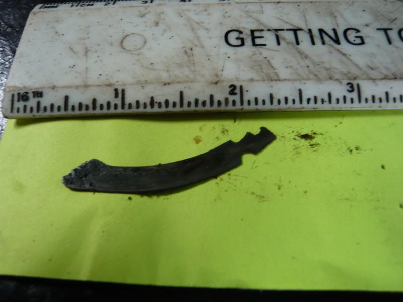

i found these 2 thin metal pices in my oil pan.
what r they? and is that what caused my probelm?

can you take a piture from another angle and something along side to judge the size.they look like rings but all yours were together?

the above photo has been updated

it looks like the channel that guides the dipstick to the sump on truck base pans but car pans don`t have them?

Midi,
Those metal pieces may be from the #3 main bearing thrust faces. You'll know more when you pull the main caps.

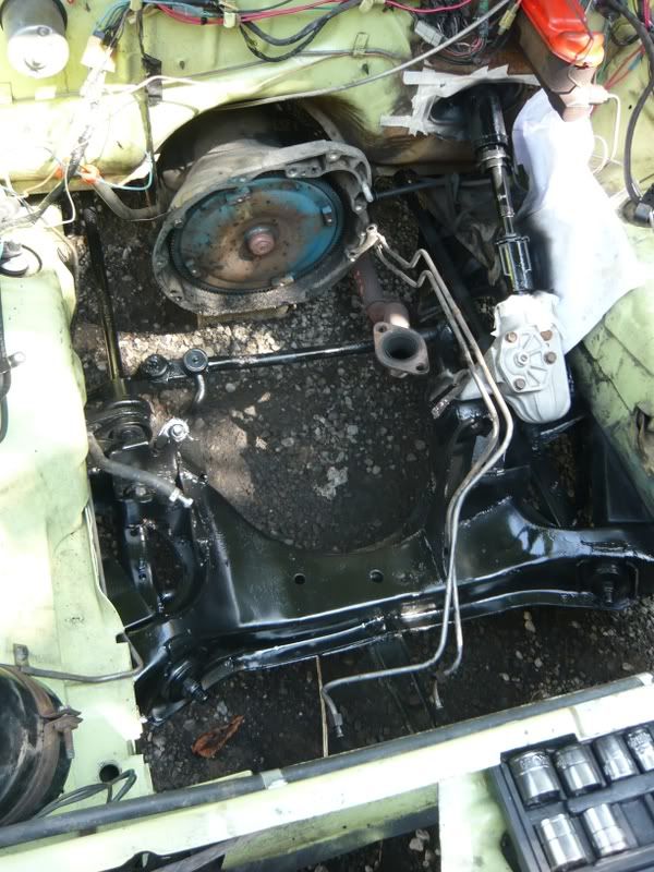

todays progress:
i'm done untill i can get parts & help. i tryed to order piston rings and 3 part store chains where out of stock so i couldn't even order them. i also am trying to scrounge up cam berings.
