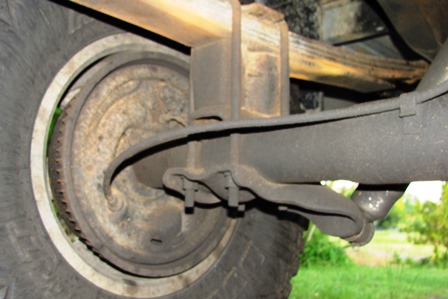

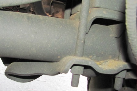

Could you use a pair of these from a Dodge pickup? You could flip them and clamp (on top) them wherever you needed to on the axle. Admittedly, they are a little clunky for a race car but may be good for test purposes.
