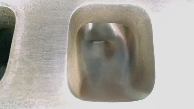

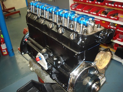

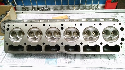

Here is the central figure in making it go faster. New cylinder head. Has 7MM valves and flows really well. :D :D

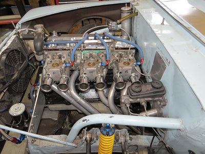

Webers don't hurt anything either! :D :D
