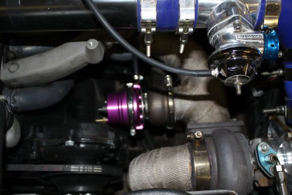

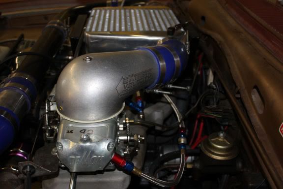

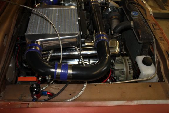

Here are some updated photos of the engine bay.
