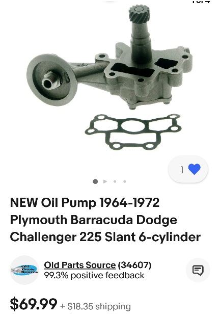

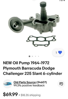

May buy this oil pump and swap drive gears.
https://www.ebay.com/itm/145584079902?m ... media=COPY

That's actually not a bad price compared to some I've seen.
Problem is in that's not nos (don't think it is as it looks like a 5 bolt version not 6) but it's probably got a little thicker rotors, which means it won't fit under the cover of the stock pump body.
I did see a rebuild kit on eBay a week or so ago.

NOS oil pump? Hope so just bought it.
https://www.ebay.com/itm/364329911341?m ... media=COPY
PostPosted: Tue Feb 13, 2024 2:30 pm
Posts: 3293
Pic shows a 5 bolt pump. I thought all OEM pumps were 6 bolt
