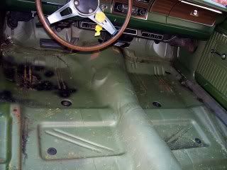

hello sl6 sages- getting ready to take apart the dashboard on my 76 feather duster for various repairs. windshield wiper pivots appear to be leaking rain water very badly. was thinking of ordering from schumacher these pivot seal kits for about $15.00 . does any fellow sage have any experience with them? would like to hear an accurate opinion about their effectiveness. thanks tons. paladin

hello slantsix dan- thanks for your advice and further info from the thread you supplied. two questions remain. first, if the pivots are worn , will it still leak and if so what is the repair? doubt if you can get new pivot mechanisms. second is the donut seal referred to on the upper shaft of the pivot just below the knurled end for the wiper arm insert. is that donut which would seem critical supplied with the schumacher kit? thanks for your ongoing interest and advice. recently had new floors and frame supports welded in at a cost of millions. dont want to have to do it again, hence repair the leak. regards paladin
