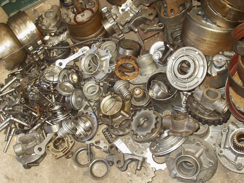

I also have a lot of good used 904 parts...
Send me a PM with a list of things you need.
