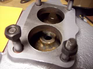

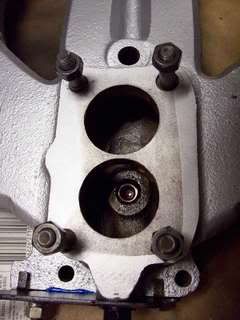

On mine, I tapped the hole that leads out to the EGR ports:
(if you look close, you'll see the threads)

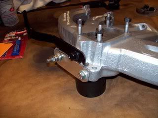

and then threaded a pipe plug in- (to prevent fuel from pooling) with the threads coated in Hi-Heat epoxy:
and cut a steel plate to shunt off the open ports:
