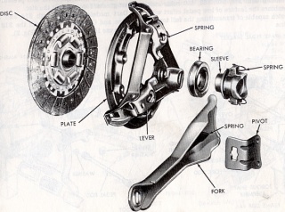

Look at the pics Doc posted. The Z-Bar pushes the the outboard end of the clutch fork rearward. The pivot causes the inboard end to move forward, pushing the release (throwout) bearing into the levers of the clutch cover which then retract the pressure plate releasing the pressure holding the clutch disk to the flywheel. The motion of a lever with a center fulcrum (pivot) is reversed at the fulcrum - otherwise it wouldn't be a lever.
*edit* I suppose it's possible to out the Z-bar in upside down but I don't see how it would ever hook up properly and even if it did that would'nt change the physics of transferring force and motion through it.
