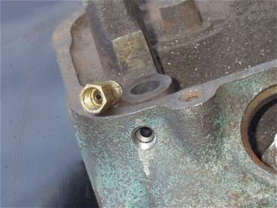

One "work-around" fix to a rocker arm shaft that does not get oil is to drill and tap a separate oil feed hole into the lower rear cylinder head bolt hole. Use a piece of tubing to feed oil into that location and it will oil the rocker arm shaft.

This is kinda what they do with the Big Block engines (sometimes), that way the rockers oil with a constant flow instead of a pulsed flow. But I would want to be real carfull and follow up with very good oil pressure checks in all conditions & the oil flow up top also. That external tap in looks like something worth looking into itself, the oil could be controled with jets to insure that the top wasnt over loaded & taking away from the bottom. There is usually a fair bit of HP gained by controlling the oil good in a engine.
