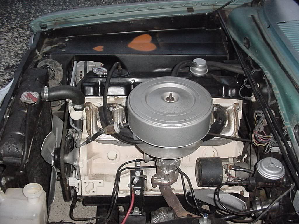

Here's another engine # riddle for you to solve. This engine is in my recently purchased (3 week ago) 64 Valiant V100.
#CT225 11 16 Wasn't my V100 suppose to have come with a 170c.i.?

CT225 11 16 is a 1966-model 225 engine made on November 16, 1965, probably at the Trenton engine plant.
The vehicle trim line (Valiant V100, V200, Signet; Dart 170, 270, GT; Lancer 170, 770, GT, etc.) had nothing to do with what engine was installed. All the engines available in A-bodies in any given year were available in all variants of the A-body. The 170 was standard equipment in all 1964 Valiants, but the 225 was optional on all of them.

Thanks Dan. So if it's a 1966 model 225 engine then it's a transplant into my 64. Is this engine rated at 140 hp then? Yahoo!
Are 2 barrel intakes and carbs readily available or am I dreaming? How about dual exhaust manifolds ? Sorry for the newbie questions but here's another one. The exhaust pipe is very small in diameter. Maybe only 1.5" in diameter. Would a larger diam. exhaust system help the engine performance any:oops:
Strange engine color scheme eh?
Correct.
Kinda-sorta. For horsepower rating information, please see this post.
Yes — there are numerous good ways (and a few bad ones) to install a 2bbl on your engine. The factory '76-'82 "Super Six" setup can be adapted to an earlier car without too much difficulty, or see Parallel-2bbl intake manfiold modification (see also this post and the photo essay link from it) for another approach particularly suitable for the '60-'66 cars with rotating-rod throttle linkage like yours.
Definitely. Dutra Duals.
If you're removing the manifolds, it's worth your while to get the good gaskets for the manifolds-to-head and the intake-to-exhaust (heat riser/hotbox) junctions.
Yes. Stock diameter is 1-7/8". You can run 2" pipes off the Dutra Duals, either "Wye" into one 2&188;" pipe and into a thoughtfully-selected muffler to avoid annoying and costly-to-resolve exhaust drone, or if you wanna make noise, duals all the way back.
If you are keeping the stock single exhaust manifold, 2¼" pipe right off it, into a thoughtfully-selected muffler per above.
Yep. Also looks like a previous owner fashioned a carburetor heat shield. See threads on the topic of engine colour here, here, here, and here.
