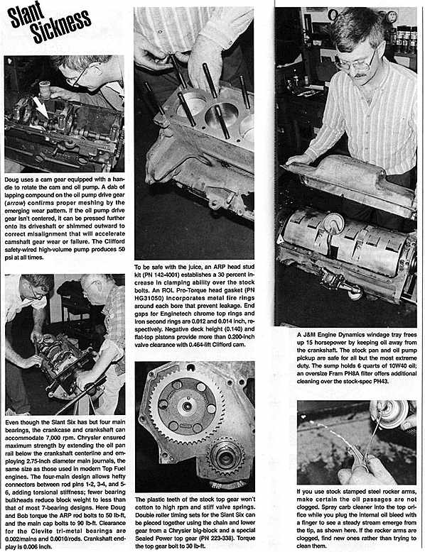

The oil passageways to the tips of the rocker arms are plugged.
If you look closely, there is a small hole right on the end of the rocker arm tip that drips oil onto the valve stem and spring.
It is common to find these passages clogged-up and my advice is do not even bother trying to clean a clogged SL6 rocker arm, most plugged ones never "come clean".
Buy a rebuilt assembly or swap-on a good used assembly.
I always test to be sure the oil passages are clear by using some carb cleaner spray. See Lower-Right Photo at this link
