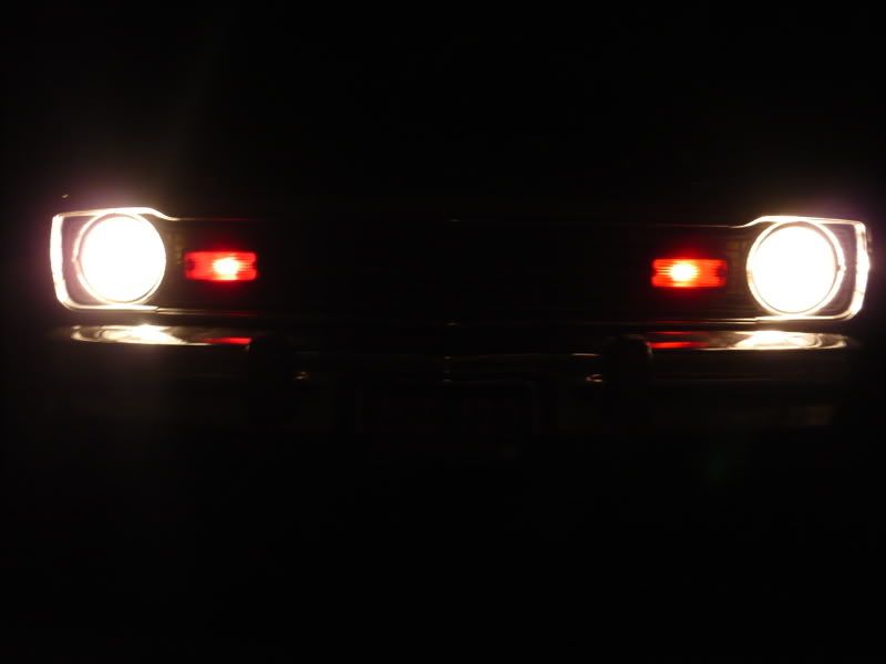

well a friend wanted to give my dart a small present so i got a set of red multi led front lights. they seem brighter than the stock amber bulbs. and look an evil red @ night. they also seem to flash slightly faster than stock when i have my hazzards on. i have had them for over a week now and i really like them any reason i shouldn't keep them. cause i think they are super cool! but @ 15.00 each wow!

MiDi, I don't think we've had occasion to talk on this level yet before, but I am an automotive lighting and safety consultant. You need to please go get those LEDs out of your car in a big hurry — like before you drive it again. They are extremely unsafe to you and those you share the roads with, for a couple of different reasons:
1) Except as special warning lamps on emergency vehicles, red light is not allowed at the front of the car, only at the back. This is critically important so that other drivers can tell at an instant glance whether they're looking at the front or the rear of a vehicle. Having to look for more details ("H'mm...do I see a tailpipe, which would make it the rear? Or wait, no, I see headlights, so it must be the front") is out of the question. The recognition needs to be instantaneous, whether it's bright and sunny out or foggy, or dark, raining, etc. The only light allowed to emanate from the front of the car is white (headlamps, auxiliary fog or driving lamps, daytime running lights, parking lights), yellow (auxiliary fog lamps, daytime running lights, parking lights), or amber (parking lights, turn signals, daytime running lights). At the rear, the reflectors, tail lamps and brake lights must be red, the turn signals must be red or amber, the reversing (back-up) lights must be white (and that's the only white light allowed to show to the rear; even the licence plate light has to be shielded such that it is not directly visible to the rear).
2) Even if your new LEDs up front were putting out amber light, "LED bulbs" like this don't perform safely in lamps designed to take bulbs. Please see this thread for more info, this Allpar page for a comparison of LED bulbs like yours vs. brighter filament bulbs, and this thread for more discussion on how LEDs might be retrofitted safely and effectively to your car.
If you want to customise or upgrade any of the lights on your car, there are plenty of options for doing so in ways that give a real improvement in function, and there are even ways of doing it that give various different kinds of improvement (or at least change) in appearance. You can easily and cheaply do some plain old maintenance that'll improve the existing lights' function. You can have better headlights, brighter signals, LED marker lights, you can add daytime running lights, an LED center 3rd brake light, you can get custom lenses that give you separate red brake/tail and amber rear turn signal lenses...lots of options. Maybe better to start by getting the turn blinker system working...? ;-)
Seriously, though, please go get those red LEDs out of the front signals on your car. They really are a serious crash hazard, and we'd rather have you around here for a long time so we can laugh at your car's interior :lol:

No, move them to your desk drawer or your trash can and switch back to bulbs now. They are not safe or effective even in rear lamps. Please read all the links I provided above. The '71-'73 Dart tail lamps are small and dim enough as it is; the "LED bulbs" make them effectively much smaller and dimmer. Not a good idea, please don't do it.
