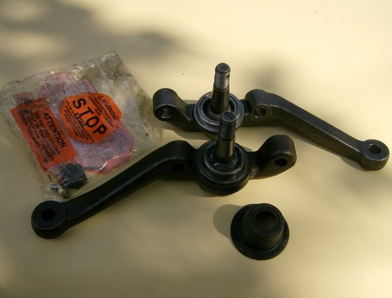

Here's the TRW unit. I'll be picking up the MOOG parts when the PM order comes in, a couple hours. time to get dirty!
nothing alarming that i could see here, the balljoint is too tight to pivot with my hand.
will post pics of MOOG parts when they arrive.
