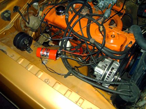

Anyone have any idea where my problems could be? Some photos of my conversion below:

The MSD has positive and negative wires to the battery, right? But are you switching it on thru the ballast resister? Maybe the resister was the first problem? The original circuit will have nothing to do with the coil anymore, aside from turning the MSD on. With a CD box you do not see constant voltage to the positive side of the coil like with points or many factory electronic ignitions.

There's 0 volts at the coil until the MSD fires it at about 400 volts (multiple times at low rpm)....
Probably not enough time for the voltmeter to react.
Goto the MSD site and read all about it......

Ballast? Look at the instructions that came with the msd box, it will tell you what model coils need what ballast resistance - That looks like a msd6 box and msd2 coil - I didn't use a ballast when I ran the same setup.
I'll backup what the others have said here - you can't measure voltage on a coil hooked to a capacitive discharge box in the same manner as our stock ignitions. Thats why the MSD instructions warn you not to hookup tachometers to coil negative and hook them to its dedicated tach line - the waveform is very different.

Yep, with an MSD box you shouldn't get a voltage reading at the coil. They're a different critter from the Mopar ignition altogether.
