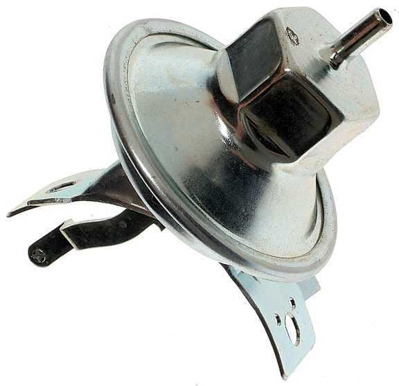

Mechanical advance mechanism:
Vacuum advance:

Reed's picture shows the weights and springs for a points distributor, without the 'governor'/limiter... the EI mechanism is similar, but has posts that are slightly adjustable for the advance springs, and you have a long looped primary spring instead of two full wound springs...
FYI, the EI vacc. can is a different beast than the points vacc can in how the armature is positioned.
