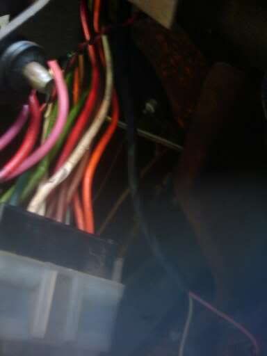

Suonds to me like you have a serious short somewhere and/or some serous corrosion on some of the bulkhead terminals.
When you say the "S-Z" section of the of the bulkhead connector, I assume you means one of the sections of the plastic connect containing a bunch of wires, right? These are nown points in the wiring harness for corrosion to build up after a few decades, leading to poor contacts, increased heat generation, and melting plastic housing. I would carefully check all portions of the bulkhead connectors, clean them, make sure the plastic housing hasn't melted and is allowing two or more of the terminals to touch.

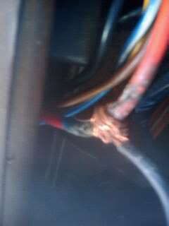

PostPosted: Thu Apr 16, 2009 1:12 pm
Joined: Sat Sep 01, 2007 7:37 pm
Posts: 37
Location: Oakland, Ca

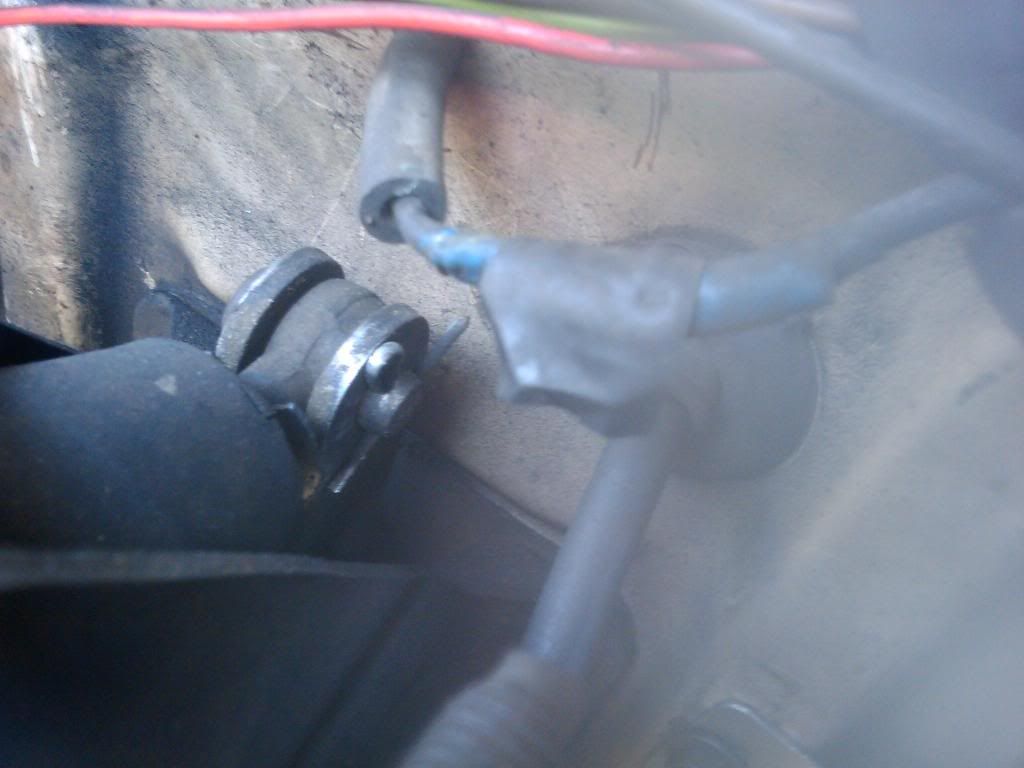

here's some pix of some of the wiring. for the record i just burnt the other connection from the ammeter - the one going from the left post in rear and spliced onto the wire going thru the shunt thru the firewall and connecting to a fusable link which goes to the relay switch. i'm looking at a diagram i got from mymopar.com that shows the wire coming from th Z spot (what a name) should be connected to the fusable link and continuing to the relay switch. i figured the picture thing out... and thanks for the complement re valve job.

PostPosted: Fri Apr 17, 2009 12:59 pm
Posts: 37

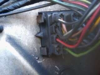

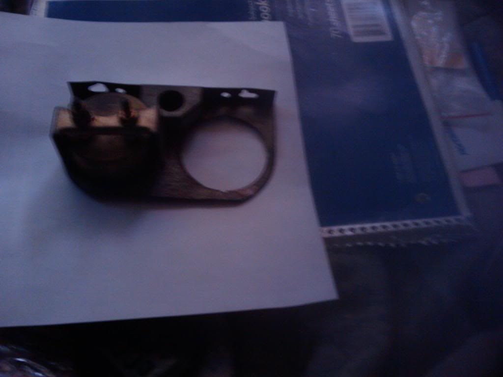

greetings... most definitely i disconnected the battery before attempting any connects or disconnects. i was actually reconnecting a post to see if my power was restored at all. picture 4 is the connection of the ammeter and ignition wire. the wire from the ammeter came from the left rear. the wire that burned came from rear right to the bypass of the z-spot. the ammeter is so old that it almost looks like orig equipment. apparently the genius bypasser took out all fusibles in the fusible links. but what would have been the ground if one went to the everhot ignition and the other went to the relay. sooooo. here's my thought: to reconnect via the original z-spot- again that's an intriguing name - removing all traces of the problematic pieces protuding... thoughts... here's the front and rear of the ammeter i removed which is actually kinda ugly and missing a big spot. also the only other difference in the comp when we touched the battery cable to the post was that i plugged in the cig lighter connection which has been suspect for a while also. update u all as i go... again thanks for the assistance. side bar... i really appreciate the assistance and one reason i enjoy the puzzle that is sandy is that i hope more women are encouraged to, if not get greasy and grimy, at least have a working knowledge when they have to take their cars for repairs...

That ampmeter is aftermarket,probly in the past the car had another electrical fire that ruined the stock ampmeter and fuse link.
