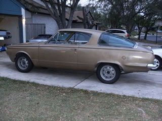

It seems to run just fine on 87. I think the guy I bought it from was a member here so you guys probably helped him think this thing through.
How many horses do you think this little beauty is puting out? 150?
Here is a pic of the car.
1966 Dart GT
1965 Barracuda

PostPosted: Sun Apr 19, 2009 7:53 pm
Pretty nice ride...
That would be 'moderate' it might be slightly higher but in the ball park....

PostPosted: Mon Apr 20, 2009 5:13 am
Posts: 17683
Looks like a great buildup. Drive, tune, enjoy...
If it's a Boss Hogg converter, it probably only stalls around 2500 on the Slant, which would be perfect.
350 carb can more than handle that buildup. I would leave it. Seymour has gone 14s with his 350 carb.
