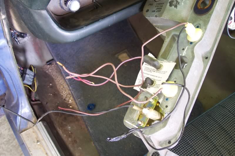

See
It's all hacked out!
All I have is the blue wire from the sending unit (not in pic) and the 2 wires in/out of the fuel gauge (both red w/blue stripe).
Someone hacked in a different temp gauge before me and must have removed all the stuff.
As I said, it did work before I removed speaker wire and a few extra toggle switches. Maybe I did remove a external regulator by mistake. Funny thing is I never throw stuff like that away when I do projects like this (in case I need to piece it back together :lol: )
So I either need to get a cluster and harness or "temporarily" add a external regulator like in the article. Or plan C, get a custom cluster from Sick 6 and be done with the whole thing :?
Well, enough of working on my own car. I need to get a truck painted.
Thanks ALOT for all the help. If anyone has suggestions on how they would deal with this situation please pass them on!

Hummm....
Looks like a bit of a redesign between '67 & '68 on the gage cluster where the external voltage limiter is missing: see my '67 below. I'm wondering if a later cluster has been swapped into you car, as this same configuration was used on several models & years. I question this because the diagram dose not match up with your cluster. Also there is no circuit board on your cluster. Perhaps someone could elaborate on this.
What dose the white tag say straddling the two gas gage terminals? Internal voltage limiter integral with gage?
Reddish wire closest to speedo should connect to 12 supply if gage has an internal limiter, and the other to the dk blue wire from sending unit. Your unit dose not appear to have external voltage limiter provisions. See photo of 67 cluster below: adjacent to speedo housing there is a cylindrical capacitor and to the right of that three slots where the limiter plugs in to the circuit board.
I can't see what is going on with your temperature gage, but that should connect to a violet wire from water temperature sensing unit in head to the center section of the bulkhead connector terminal "R" on diagram: B, "engine compartment", and a 5 V feed from the limiter.
That five way connector shown on diagram A, "dash", third wire down is black, and feeds the voltage limiter from the fuse block, which after stepped down to 5V by the limiter feeds both gas & temperature gages. You will have to dig around under the dash to find the mates to these clipped leads from the gage cluster. There may be a five way connector up under there that someone spliced into.
Take your diagram and trace out each wire one at a time from the sending unit, temperature sending unit, 12 V feed from fuse block, ground leg for lights etc. and label them with a bit of masking tape, as you go this will become clear to you. Then make the necessary splices to re connect all that mess up. Take your time, be methodical, double check everything, and make sure the battery is disconnected while doing this work. REMEMBER the AMP gage is wired HOT to the battery. If you ground one of those big red wires out you will have a smoky melt down.
I had to make up a small harness to jump out several burnt off pins that the five way connector plugged on to (uper right where orange wire terminates). The yellow wire is substituted for the purple from temperature sending unit. I labeled the termination points on the circuit board B, Y, G, O; for blue, yellow, green orange etc. so I wouldn't screw it up during reassembly. The black feed wire is soldered to the center leg of the voltage limiter. The right slot or leg feeds 5V to both the gas & temperature gages via circuit board.
Dash Lights feed by 12 V via orange wires from rheostat on headlight switch, and to ground by black wire, and need to be in parallel.

I have been looking, thinking, and comparing your gage cluster to mine. I think someone has removed the right side circuit board, hacked a great gaping hole in the pot metal casting to mount an after market or different temperature gage. By doing this they must have scrapped the voltage limiter, most likely fried the gas gage with a 12 V feed.
You may need to locate a right side circuit board, the five pin female side of the connector, a new temperature gage & gas gage, voltage limiter & condenser to repair this unit correctly. Probably a whole cluster will be easer to find.
PM MiDi, I saw shelves full of clusters at his new place of employment in his latest post on social corner, perhaps he can get you one.
Oh, I see just what you need in one of these photos.

I am just going to rig up a external regulator/limiter and get the dash lights to work for now. Till I can find a different cluster and harness.
Thanks for posting the picture! I really didn't know what was missing :lol:

Tonight thanks to everyone's help I reached up under the dash of a '71 Swinger and pulled out a regulator!!!!
Thanks for the pics and article. Without the visualization there is no way I would have known what I was missing and needed.
