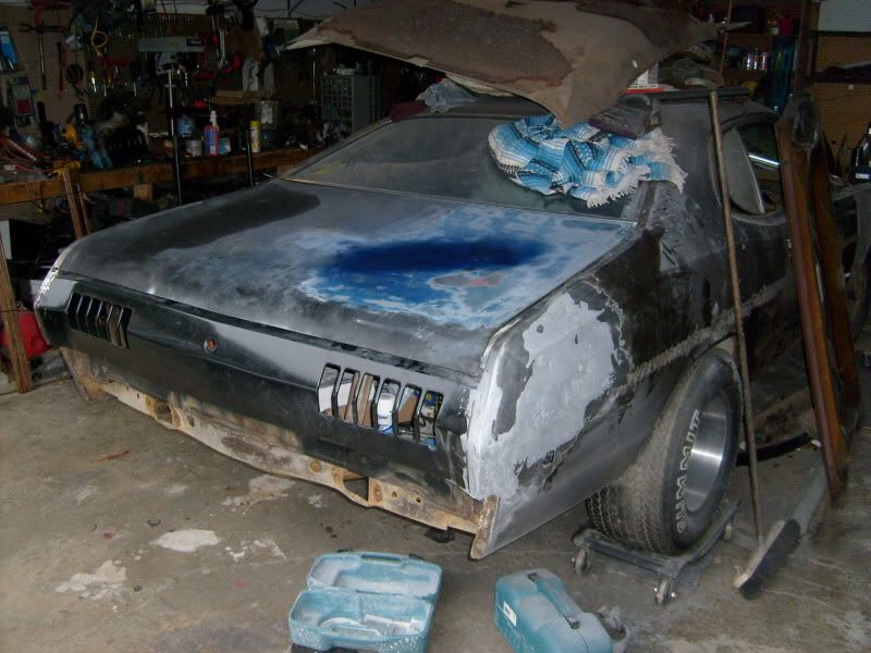

Reed; I thought the car was a '74; that pic you show is definitely of an older model and of a Demon rather than a Duster (or are you mixing/matching various A body parts here in the build?)
PostPosted: Mon Dec 07, 2009 9:10 am
Posts: 13372
Yep, the shell is a 74 Duster. The tail panel is a replacement Demon tail panel and the trunk lid is off a 70 Duster. The entire front clip is off of a 67 Dart GT. The bucket seats are out of a 96 Sebring. It will have 68 Dart side running lights (which I would like to wire to become functioning blinkers) and fender top turn signals off of a 68 car as well (can't remember which one- the bullet style, not the more common 70s style). I love mixing and matching mopar parts. Image
