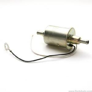

Howdy Lou,
I don't like to complicate systems more than necessary so I run a pump suited to the purpose.
The one I use for my SUs makes 42 gph. Is that enough for your needs?

PostPosted: Thu Jan 14, 2010 6:55 pm
Joined: Fri Feb 06, 2004 9:47 pm
Posts: 526
Is this pump making buzzing/clicking/thudding noise? That's solenoid type that pulses. Not suitable either especially for weber. Rotory type is preferred. I'm asking about that for the reason as I wanted to buy quality type that lasts as long as OEM intank pump types (they are rotory also).
But mine needs to be in range of 3 to 4.5 PSI range. And does NAPA sells one like rotory pump for my needs?
Cheers, Wizard

I haven't found a sub 4 lb vane or gearotor pump under $150.00.
The Mr Gasket solenoid job I'm using gives the SUs no grief what so ever, and I believe they're more sensitive to pulse & pressure than the Webers are.
Admittedly my only Weber set's still on the shelf so I'm relying on memory of opinions from road racers back in the '60s on that.
