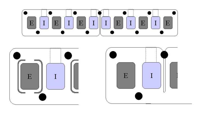

PostPosted: Fri Aug 02, 2002 4:23 pm
Good questions
Many things in the slant were overbuilt - just look at that 'beefy' bottom end as proof. Will the stock studs be okay? I think so but if they're not, its relatively easy to retrofit with high strength stuff.
On the topic of thermal expansion, I like your idea of elongated holes - you might also consider making 2 pieces, each handling 3 cylinders.
Since I believe you said you'd be using a water jet cutter, you could consider other wacky tricks to handle exhaust thermal gradients a few of which I've sketched below. The pencil thin jet could cut thermal expansion pockets around exhaust ports or just keep on producing expansion slots.
I'm curious to see the final design you arrive at and how things turn out. Onwards & upwards . . .
<img src="http://slantsix.org/photos/sl6injectionplate.jpg" width=425>

PostPosted: Fri Aug 02, 2002 4:34 pm
: Good questions
: Many things in the slant were overbuilt - just
: look at that 'beefy' bottom end as proof.
: Will the stock studs be okay? I think so but
: if they're not, its relatively easy to
: retrofit with high strength stuff.
: On the topic of thermal expansion, I like your
: idea of elongated holes - you might also
: consider making 2 pieces, each handling 3
: cylinders.
: Since I believe you said you'd be using a water
: jet cutter, you could consider other wacky
: tricks to handle exhaust thermal gradients a
: few of which I've sketched below. The pencil
: thin jet could cut thermal expansion pockets
: around exhaust ports or just keep on
: producing expansion slots.
: I'm curious to see the final design you arrive
: at and how things turn out. Onwards &
: upwards . . .
I like the idea of the slots around the exhaust.. real interesting, I'll think about that some more.
Initial sketch is at the shop, but I won't hear back untill I return from my trip in a week or so.
