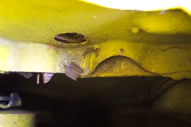

I have to amend my previous statements with the following:
I have included a photo illustrating the 5/8th inch hole in the passenger’s side hood hinge attachment location. After closer inspection, I now believe that the 5/8th hole had been drilled by previous owner to facilitate cowl cleaning when he had the front fenders removed. Just to the right of the drilled hole, you can see a raised, or puckered section of the joint between floor of cowl and vertical end cap of cowl. That pucker is the drain for the cowl..
I cleaned my cowl out while I had my heater box removed for re-fitment of internal gaskets, and heater core. With the heater box removed, and driver’s side plenum removed, access to internal cowl area is easer, as one can get his hand up into the spot to dig, scrape, and vacuum out the built up crud.
