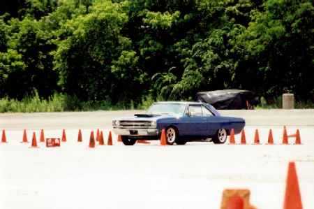

I still run the stock leafs. I know that they are old. Here's a pic. The shocks are new. Just reg ones.

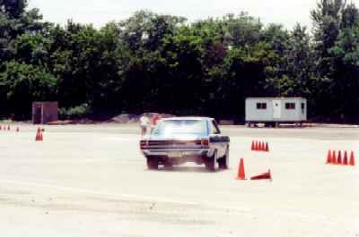

Here's A pic of the back end at a corner!

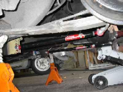

Maybe I'm missing something but it appears to me that you're trying to swing the axle in two different arcs at the same time . . . the result may be that you've effectively formed a rigid geometry between the lower links and the leaf springs. Its like you're running no suspension and so its tough to keep the wheels in contact with the road.

: Maybe I'm missing something but it appears to
: me that you're trying to swing the axle in
: two different arcs at the same time . . .
: the result may be that you've effectively
: formed a rigid geometry between the lower
: links and the leaf springs. Its like you're
: running no suspension and so its tough to
: keep the wheels in contact with the road.
That is the first thing that I thought of when I saw the picture.
There used to be a product named "Traction Masters" that worked like what you are trying to do. The rear pivot point has centered under the axle and the front pivot was centered under the front spring mount. Thus perserving the suspension arc.
Competion Engineering used to make a similar setup that had the front pivot bolted onto the spring right before the spring eye and the rear pivot just aft of the axle. They also had the bar running a bit longer, past the reat pivot point, so you could lock-out the spring action by running a bolt thru the rear bar.
The current Cal-Tracs do something similar, with a more elaborate front mounting point, combining the spring and bar into one.
The panhard bar may also be excessive. The rear suspension is fairly stable when you use poly bushings and good shackles.

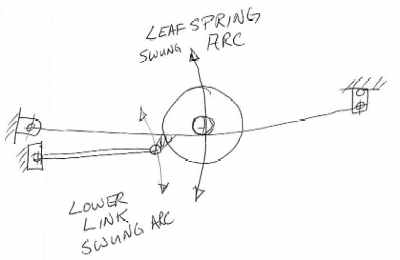

The locating links in that setup give you pretty questionable suspension geometry. The leaf springs force the suspension to follow one arc, while the links move in a different arc. The result is that the springs have to twist, or the links have to stretch, for the suspension to go anyplace. This not only causes wheel hop, but it places considerable stress on the parts. It's only a matter of time before something breaks. And trying to figure out what the suspension geometry of a setup that relies on its parts bending is a nightmare.
While Chevy guys with their flexy monoleaf springs can get away with running those kinds of bars, Mopar drivers can't. You need a design that works with your leaf springs, not against them. The simplest way is to make a link that basically stiffens up the front leaf, like the Cal-Trac bars. You could, presumably, change your leaf spring perches so as to make the axle rotate around the leaf springs, but that seems like a lot of work.

They may cure wheel hop, but those link bars are not a good match for the suspension. They turn it into a wierd, bound-up hybrid between leaf springs and a four link. I still say you should either get something that stiffens the front leaves, or go to a true four link.

I can't see the Panhard bars from the picture you posted, and I'm having trouble imagining how you could use two of them. Can you post a picture showing them, or a sketch of how they're arranged?

Also, Matt is right, I can't see any Panhard bars in your pic. A Panhard bar mounts parallel to the axle housing and it would be tough to use two Panhard bars without causing the same stretching/bending problem of arcs. A Watts linkage might help, though. Check out <A HREF="http://www.tsmmfg.com">www.tsmmfg.com</A>.
If you have old leafs and have never tried new, I recommend you get some HD leafs with PolyU bushings. I only run leafs on my '64 rear suspension (no sway bar even), and it is not all over the place on the track. You may have to have the leafs de-arched or custom made so they are stiff but don't ride too high, but some strong 5 or 6 leaf packs ought to make a huge difference.

I too, was wondering if the problem was an over aggressive shift kit in the 904. Matt, the pivioting axle over the leaf spring with the control bar is called a "leaf link". How to make one is described in my old DC manuals. Just about everybody abandoned that approach for 4 links and ladder bars and of course the cal-tracs. I don't think it would be good for an autocross car. But maybe with the panhard bar... Hmmm, I will have to think on that one.

It won't behave like a four link at all unless the axle is free to rotate about the springs. If that were the case, that suspension geometry would give you some pretty severe wheel hop, so I'm assuming the axle is attached to the leaf springs in the conventional way. It looks to me like he's running a set of Chevy-style traction bars.
